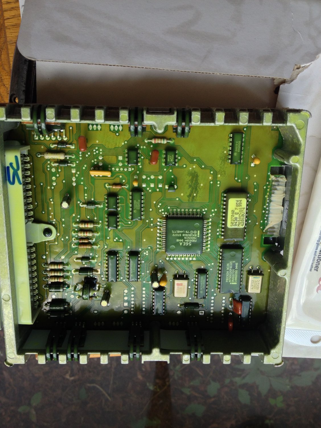

If you want, just remove the PCM and snap a few pics of the control board and let us have a look.

I have the coffee can on the passenger side, it is good. I did not know there was another under the coolant reservoir, i will check there. I will also pull the PCM and take pictures but will be a few days.

Pulled PCM, visually inspected and it looks fine in my opinion. I did notice where some water has run down the black grommet over time and collected some silt toward the bottom.
