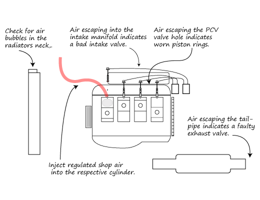

One very useful tool when it comes to engine
health is a leak-down tester.
The big difference between gas and diesel is
how you get the air in. With Diesel you don't
have a spark plug. The easy way is to use the
glow plug hole and an adaptor so you can mate
the line to the hold. Also they say to check the
coolant for bubbles and I would also pop the fuel
filter cap and watch there also.
Here is a how to make a DIY one your self.
