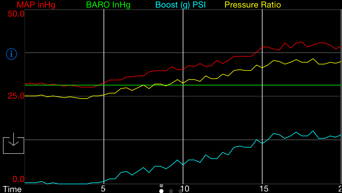

Here is the screen grab from Dash Boss. I had the truck at idle, and then ran it up to 2500RPM. I wasn't sure which of the boost parameters I should have used, so I had multiple.

that graph its not what you need though
Instead of time or Duration of the test we need RPM. We Can NOT tell at what point you hit 2500rpm
We need specific Gauge values for the set Points
Set Points meaning (KOEO--Idle--2500rpm)
as far as I can tell the Graph showed Gauge Values for specific Times the test ran

Ok, got the screen grabs for KOEO, Idle and ~2500rpm
boost and BARO look good, bu I see that the MAP reading jumps up more than 1PSI, so should I replace the sensor?

That boost looks really low, even out of gear at 2,500 rpm's.
The other thing I don't see and I'm trying to pull myself on my Dashboss is the EBP readings as those too should match BARO and MAP as Blades notes above.

AV, you don't build more than about 1psi of boost without a load (2500 rpm in park). The real probem I see with your readings I'd the difference between map and baro is 3.9, but your boost reads 1.3. Shouldn't the boost the three difference in those two. But I don't use dash boss, so maybe I don't understand something.
