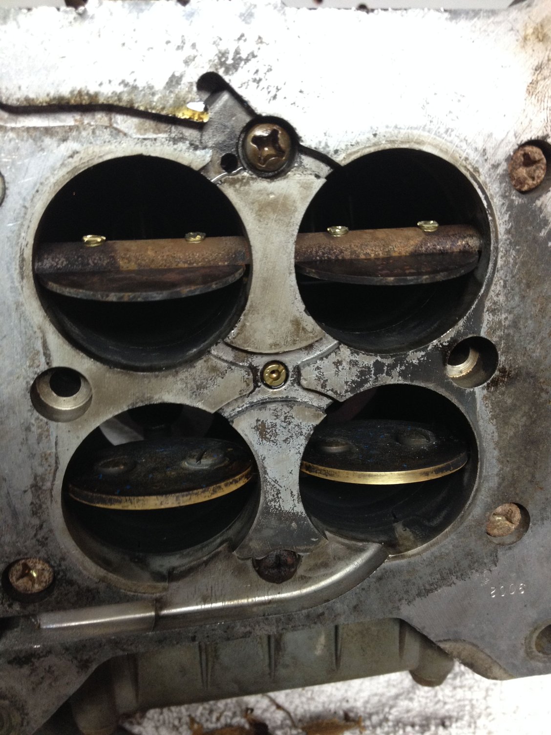

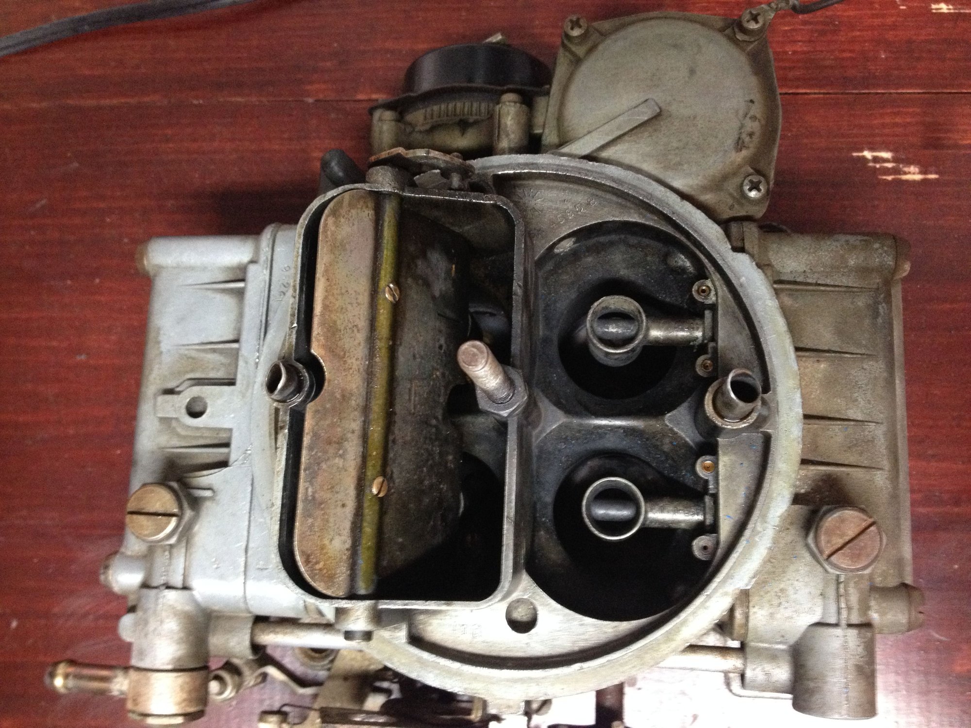

I got the carb off last night. disassembled and it was flat out fugly inside. Debris, tarnish, gunk, Etc.
The vents and jets were gummed up
embarrassingly corroded and filthy
Generally Gummed up.
So, the carb is a 4160 double pumper. 600 CFM. Old, obsolete design. Can anyone see the benefit of purchasing the refresh kit# 37-1536 at a price of $92 to $102? $92 was the best price I found BTW. Would I just be better off going with a newer, mechanical secondary carb?

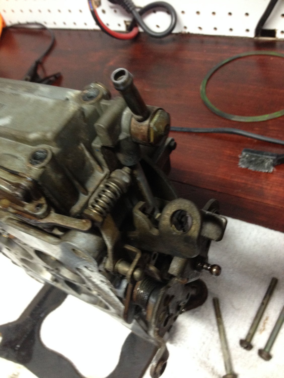

What is this and do I need it?!?
I'm guessing it is smog related. None of the vacuum hoses were connected and, when I got it off it was so carbon'd up, I don't even this air could pass. Is there a delete plate for this?
Emissions?!?
None of these were connected or capped.
Thanks for your help with this stuff guys.
