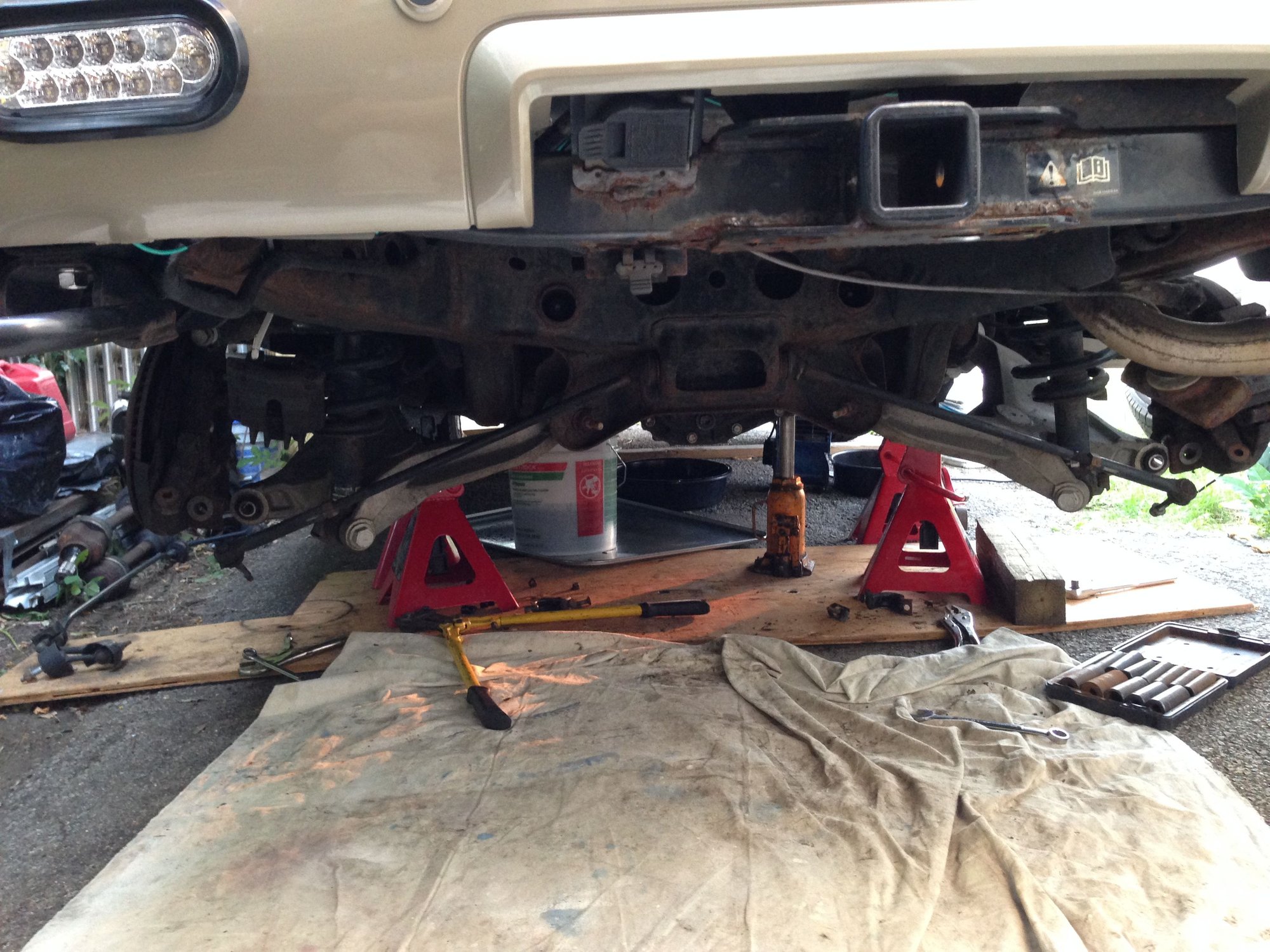

Use 2 if you have them, one on each side. This will apply more even pressure and allow it to pop out easier.

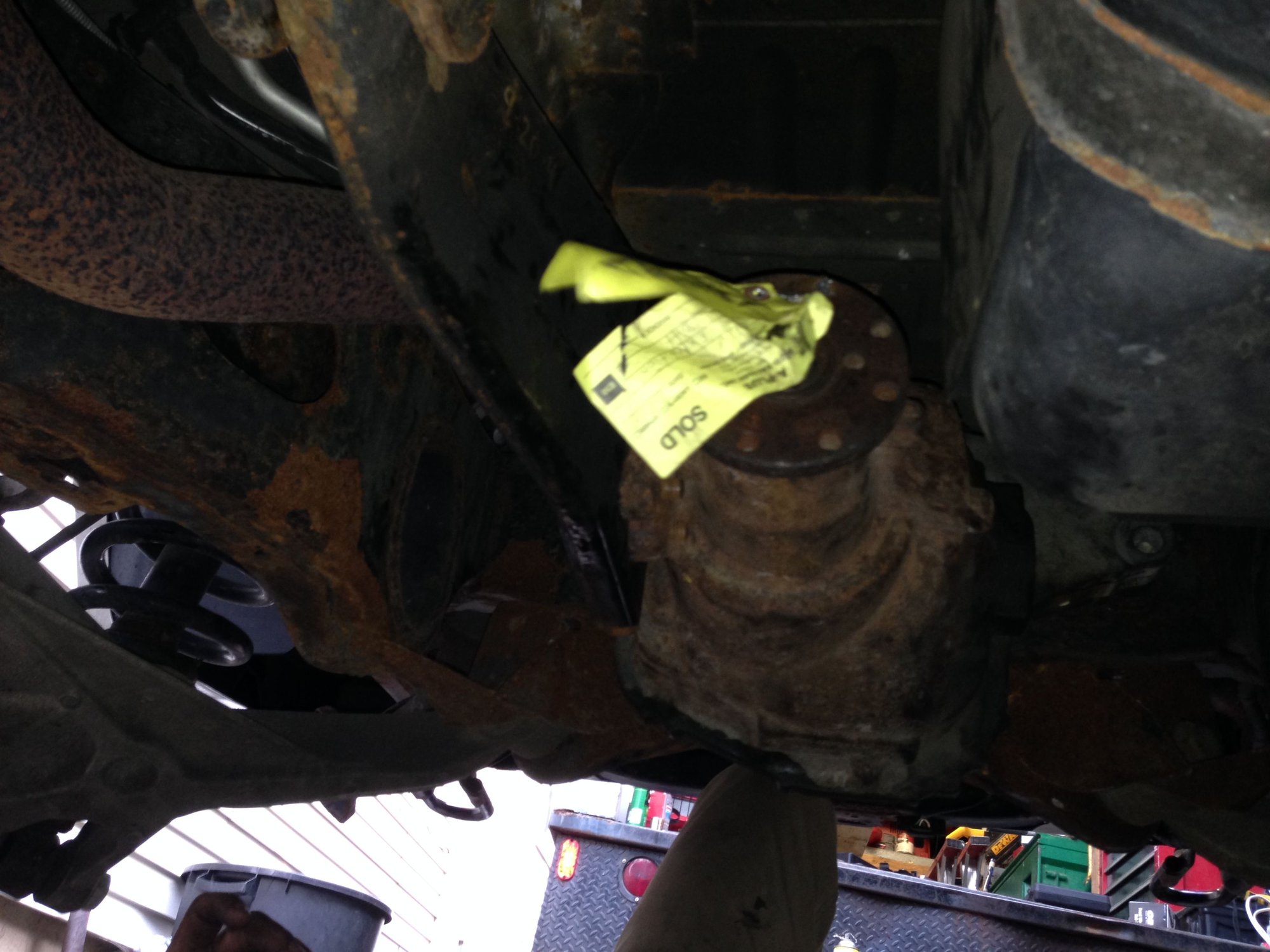

Ok, Yes the double pry worked out great. I used a 4' and a 2'. They popped right out with some pressure. Taking the rear end out was not too bad at all.. Basically just let it drop in my driveway. However installing the replacement was not an easy job for myself. It was very difficult lifting it up in there.. 30 minutes later, got it in without indecent. Any kind of grease or sealant required for the new axle seals that press up to the differential or nothing at all? Thanks
