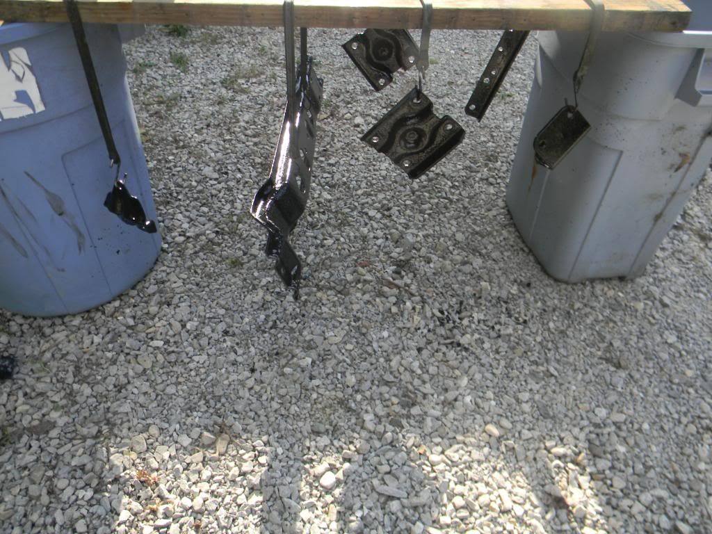

big fan of por.
stuff is tuff as nails, expensive but i dont mind because its quality.

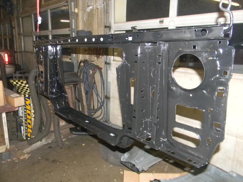

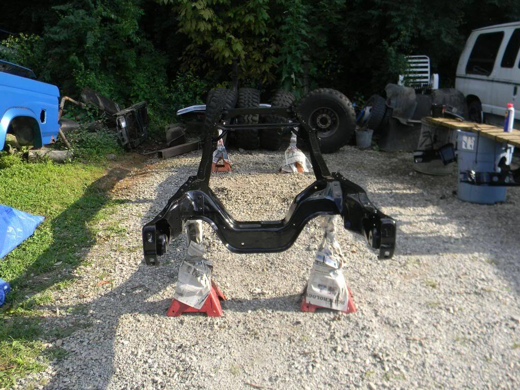

best way to prep is to have the frame or whatever you are doing sandblasted, por sticks very well to rusted pitted metal but not to smooth metal. so if it is sanblasted it gives the entire surface a rough texture for the por to bite to.
i usually do 3 coats of por, then 2-3 coats of their topcoat.
have done my 97 frame, my 97 cab and bed and core support. then uncles 84 frame, core support, cab. all the misc frame brackets and crossmembers we just hang up with bungees
sanblasting is best option, its cheap and much easier than wire wheeling and much more efffective.
i have used brushes to apply it, but next project i do i am going to spray it with a cheap harbor freight gun, brushing is very time consuming, but mine have turned out great.
i have ordered all of mine in the past directly from por.
oh and p.s. if if its warm out, wear a pair of old jeans, and old long sleeve, and buy a box of gloves, if using those precautions, if your like me, you'll end up wearin some of it
and they dont lie when they say it doesnt come off your skin oncedry, usually takes a couple weeks
