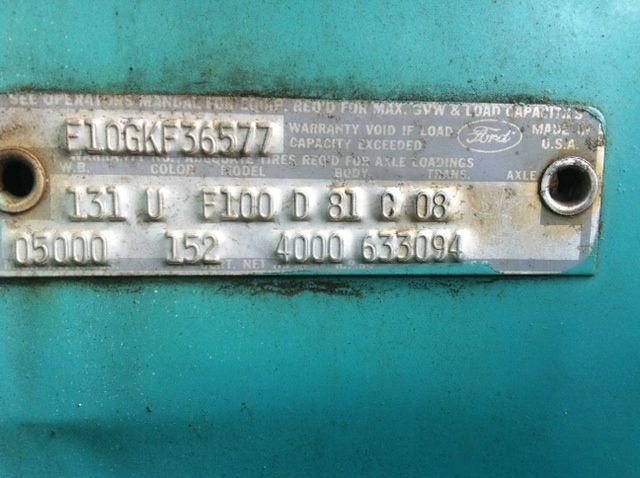

I have a 69 F100 with a 302 engine, column shift three speed. I think I have a T18 but I could be wrong. The tranny is original to the truck, but has NO ID as far as I can see. I got the door tag though, it is original too. Thanks.

OK, apparently according to this, the "C" code is the 3.03 transmission, but on the site it does not list it being paired with a 302 engine. So... Is it something a dealer did?

C trans code is a 3.03 for '69. G = 302.
Decoding Your 1969 Ford Truck VIN - FORDification.com

Many thanks. It would appear I was looking in the wrong spot.
