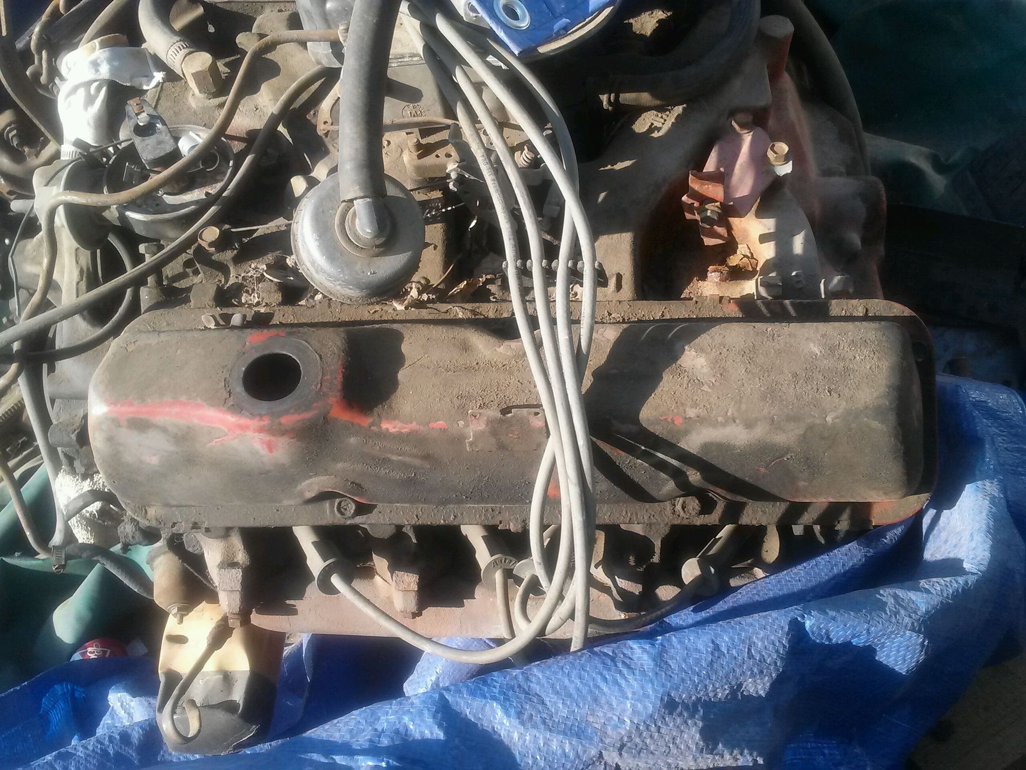

Here is a picture of the valve cover...
Here is the valve cover... 5 bolts makes it an FE, right?

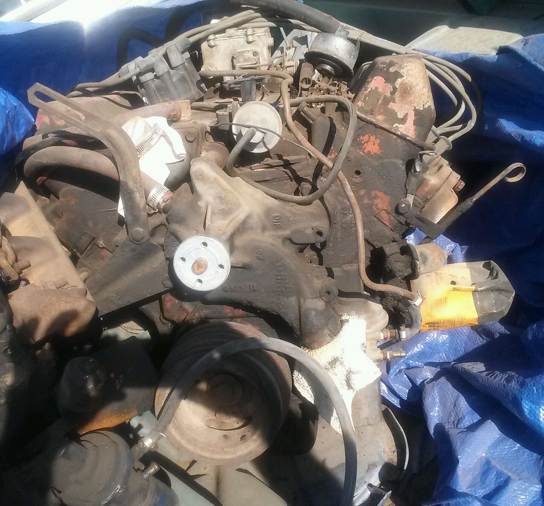

Here is the front of the motor... Do not let the 302 exhaust manifold on the left confuse the image. The two motors are sitting against each other in the back of my ranger. The engine came of an old ford pickup but I don't believe it was original. I have been advised that it is a large displacement engine... Could it be a 410?

It's an FE. The "352" in your picture helps identify it as an FE, but doesn't guarantee it's a 352 as many FEs have that 352 cast there. If it originally came out of a '65 - '66 (or even '67) F100 it would have been a 352. It is unlikely to be a 410 as that was a fairly rare Mercury car engine available only in/around '66 - '67 (someone will have the exact info, TBM3 for one, and post it). The only sure way to tell what size FE you have is by measuring bore and stroke. 352s are 4.00 x 3.50. 360s are 4.05 x 3.50. 390s are 4.05 x 3.78. These are the common truck engines. Some of the car engines include 406, 410, 427, and 428 engines. The 406 and 427 engines are solid lifter race engines. You can get some useful information by checking the cylinder head casting info located between the two center spark plugs on each head. Engine production dates are stamped on one of four machined bosses, two on each side just below the deck surface. The codes are alphanumeric, such as 5L136. The 5 represents the year, the L is the month, and the next two numbers are the date. Hope this helps some.
Some of the car engines include 406, 410, 427, and 428 engines. The 406 and 427 engines are solid lifter race engines. You can get some useful information by checking the cylinder head casting info located between the two center spark plugs on each head. Engine production dates are stamped on one of four machined bosses, two on each side just below the deck surface. The codes are alphanumeric, such as 5L13. The 5 represents the year, the L is the month, and the next two numbers are the date. Hope this helps some.
410 = 1966/67 Mercury Parklane only.
5L13 (You typed 5L136): November (L) 13, 1965 (5).
A = January, M = December, the letter I is skipped.
