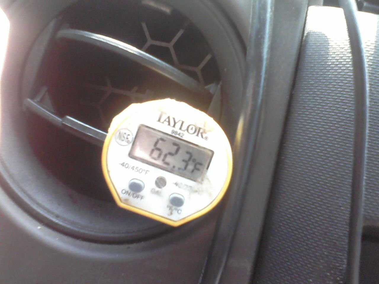

not exactly the same combo, but some scientific data for you to go by.
2010 f150 5.4
Pic #1: engine idling, 85° outside with air conditioning set to full cold and blower to maximum -- Not in the "max A/C" setting, Not set to recirculate inside air. pretty consistent with 62° vent temps
Pic #2: engine idling, same temps outside but with the A/C set to "max A/C". pretty consistent at 47° vent temps.
these two pictures were actually shot in reverse order. i let it get as cold as it would at idle in the Max A/C setting, then set it to cool the outside air and the the vent temps stabilize. then, because i started getting hot, i turned it back to "max A/C" and the vent temps came back down to 47° within a minute or so.
must shut the water off to the heater core in "max" ... can't think of any reason why you would get nearly a 20° drop in vent temps otherwise.
while driving the vent temps did get down to about 43° in "max" but i didn't get a picture, because ... well ... i was driving.
don't know if it would help or not .. but there ya go. that's what my work truck does.

Max A/C just closes the fresh air door, recirculating the air. It's easier on the system to cool air at 62 degrees than it is at 85 degrees. That's why you get better cooling. I don't think anything gets shut off to the heater core or anything

perhaps, but the inside of the truck was not that cool. had been sitting in the sun most of the morning and the AC was only running about 5 minutes.
prior to running the AC the thermometer in the vent said 100°F and i doubt very much that the cab had cooled down that much in that time frame.
i'll try to confirm whether it has a valve in the heater core lines or not.
