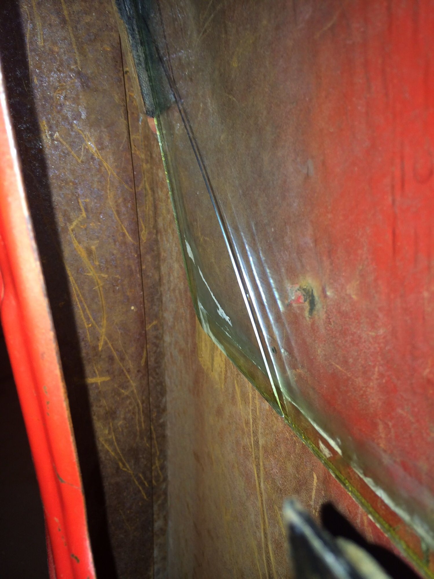

This is the drivers side I am working on. I don't find any clip holding the window in the guide. The window is hitting the door and that seems to be what's keeping it from dropping to the bottom. This pic shows where the glass is hitting the door. I'm wondering if my guides are bent or something.
You can see from this pic that the glass has dropped below the bottom of the guides and is being held up at the spot where it's hitting the inside of the door.

You need to loosen your division bar. Two bolts at the bottom. One screw at the very top. Then you can scoot it over and get the glass out.
Excellent. Just the advice I was needing. Thanks.

You may need to pull down the first little part of the window seal on top to give the division bar enough room the slide over. It has small screws holding it in place. It will flex quite a bit, but be careful not to damage it or permanently bend it.

Thanks Doc. Yes, glass is out. It was the top screw on the divider. I removed that one screw, the divider slid over just a bit and the glass literally dropped free. Now I need to order new glass. Probably go ahead with all new delta, seals, etc at the same time.
