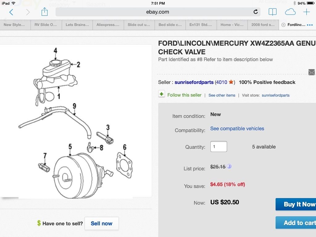

From: DFW, TX-GoldCanyon, AZ
Hi Jim, the check valve actually plugs into the Brake Booster in most cases. It is the right angle black or white plastic fitting the the hose is connected to. What you need to do is to follow the instructions I left earlier and pull that valve from the booster right after having shut off the engine. A good booster and check valve will retain vacuum for a minute or so after having shut off the engine, so when you pry that valve out of the booster, you should hear vacuum in the booster. Look at the pictures below. The right angle valve, or the one with the red cap in the second pic, is what you want to pull out of the booster. Your truck acts just like a number of other vehicles I have seen and worked on with a bad check valve.
Part #8 in the third picture
