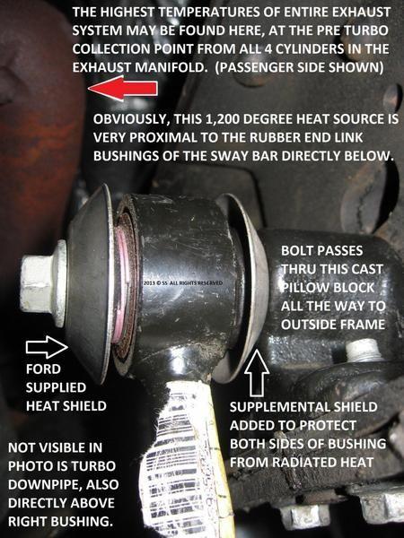

Here are a few pics of the cast pillow block in the original in frame orientation. (No lift)
The text embedded into the photos was written for another thread, and it was easier to link the annotated photos rather than hunt for the originals without the text.
Installation of the passenger side (curb side) Ford stabilizer endllink part number 1C3Z-5K483-BA. Photo illustrates proximity to heat sources and shows adding another protective heat shield to bushings. The starter is in the way of top bolt installation, so frame mounted cast support (pillow) block is removed first, then reattached to frame with endlink pre-assembled to it. IMG 0433
Installation of the passenger side (curb side) Ford stabilizer endllink part number 1C3Z-5K483-BA. Photo illustrates the frame mounted cast support (pillow) block that is removed first, then reattached to frame with endlink pre-assembled to it. IMG 0438
Sources of radiated heat that can accelerate degradation of the rubber membranes that retain the grease in the OEM stabilizer end link eyelet bushings. IMG 0455
Sources of radiated heat that can accelerate degradation of the rubber membranes that retain the grease in the OEM stabilizer end link eyelet bushings. IMG 0456
Installation of driver's side Ford factory end link, showing proximity to exhaust manifold and the added heat shields on both sides of upper eyelet bushing. IMG 0447

Now we're talking. I did find one for the right side on flea bay and that is exactly what it looks like and it is nothing like the ones that are on there now.
