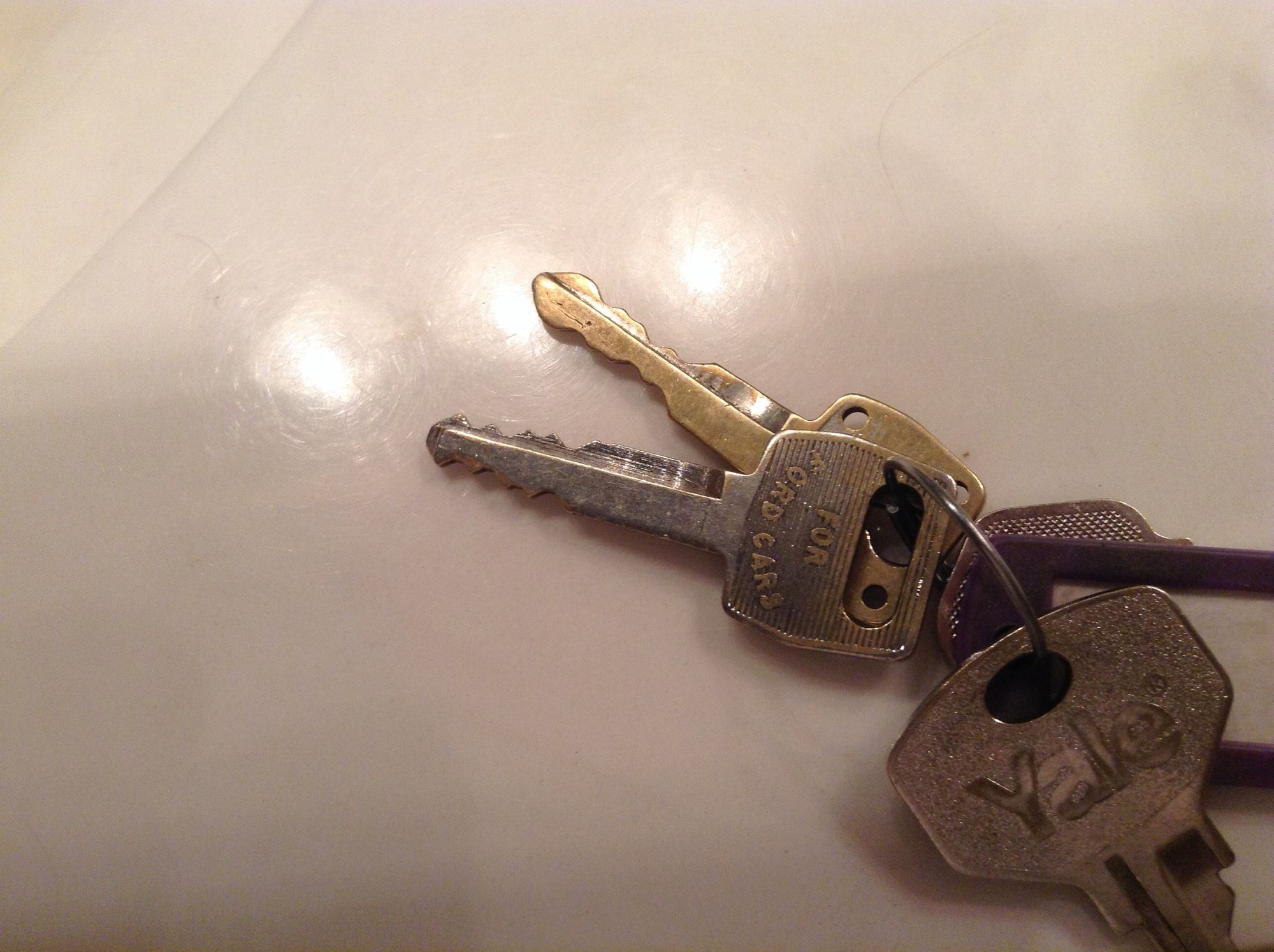

Paul/RW - We missed a bet today on comparing keys. Here's a shot of my two ignition keys for my 81's, and the door keys are backwards of these such that they won't of in. If your ignition key is like mine then your door locks must be backward from the later door locks or the key wouldn't go in. So, all I would need are the 80 door locks - assuming they can be reset to take a different key. Or, a full ignition and door lock set.
Did not need to compare keys. I already know the same blank fits the ignition from back in the 60's, to around 91.
Yes, the door locks are reversed so the square head key can go in.
