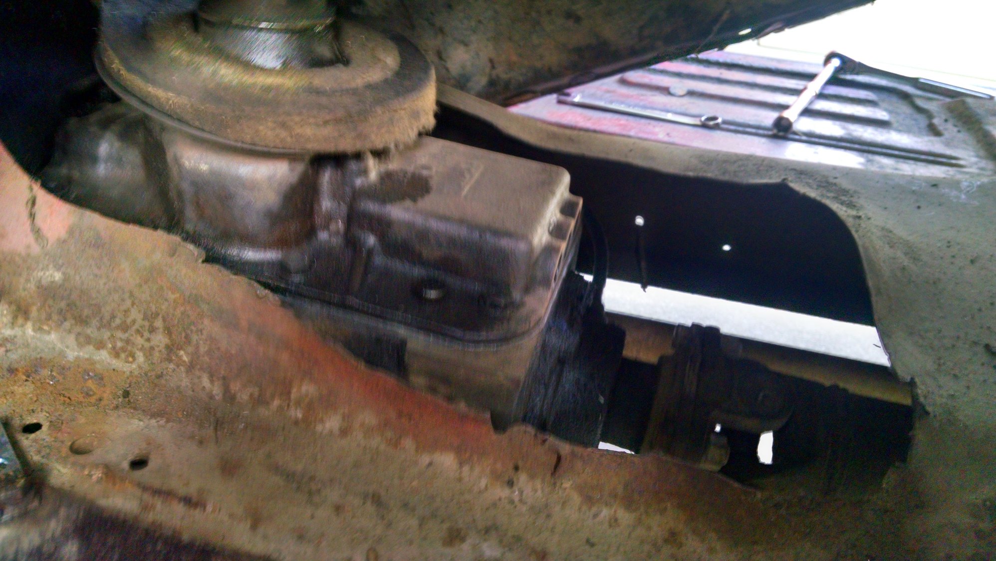

I pulled the hump off my 62 to see about putting some bolts in to hold it down. Shock! The transmission and hump are both replacements.

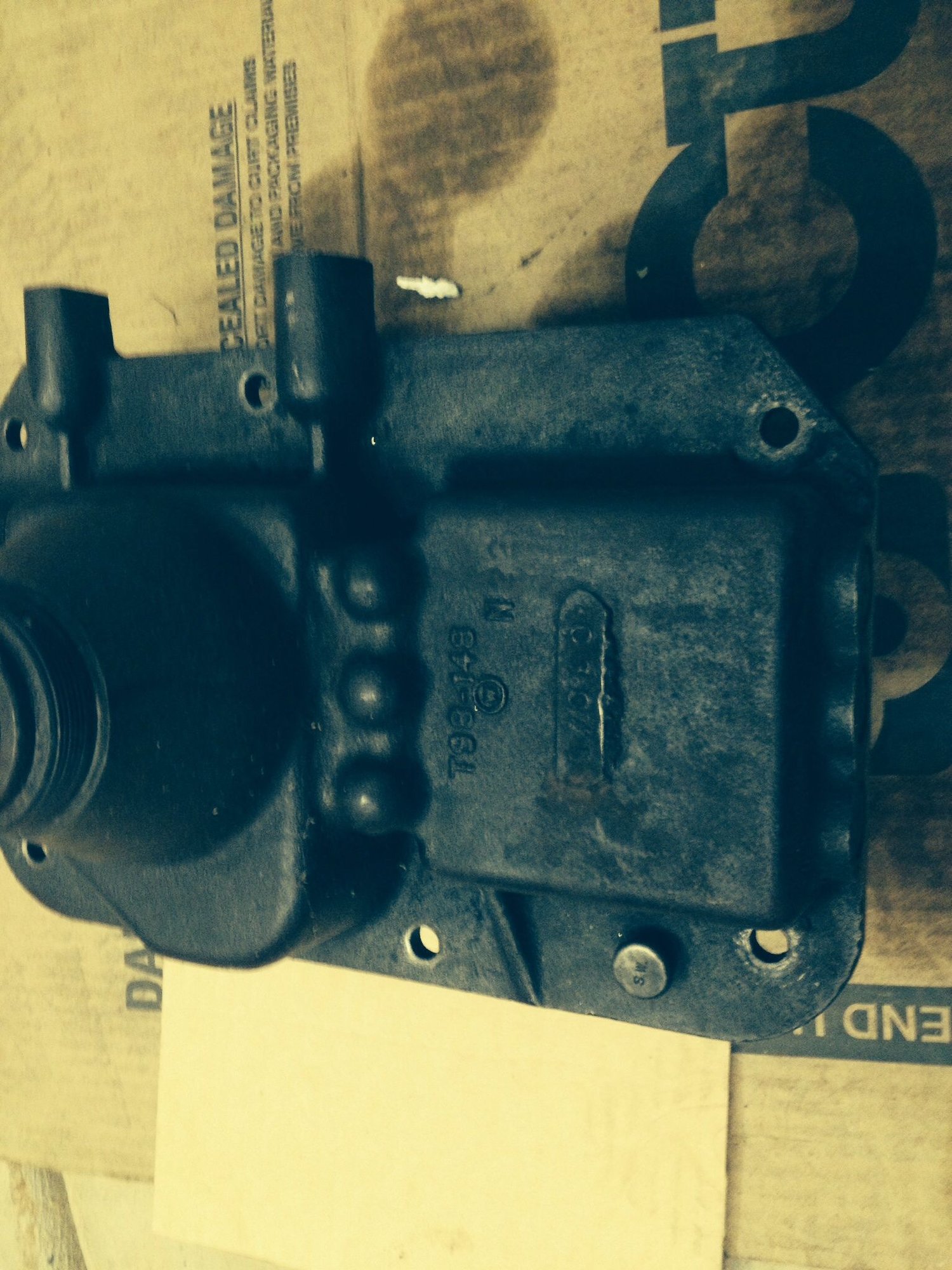

Aside from the three-on-the-tree steering column, the hack job on the sheet metal is a pretty good sign that someone threw this 4-speed in at some point in the past. From the looks of it and these stampings on the top, is there any way to know what the gear ratios might be?

That says t98 what engine is in the truck
A working truck tranny

Borg Warner T-98 4 speed optional: 1953/64 F100/700 I-6 & V8 (272/292 Y block).
