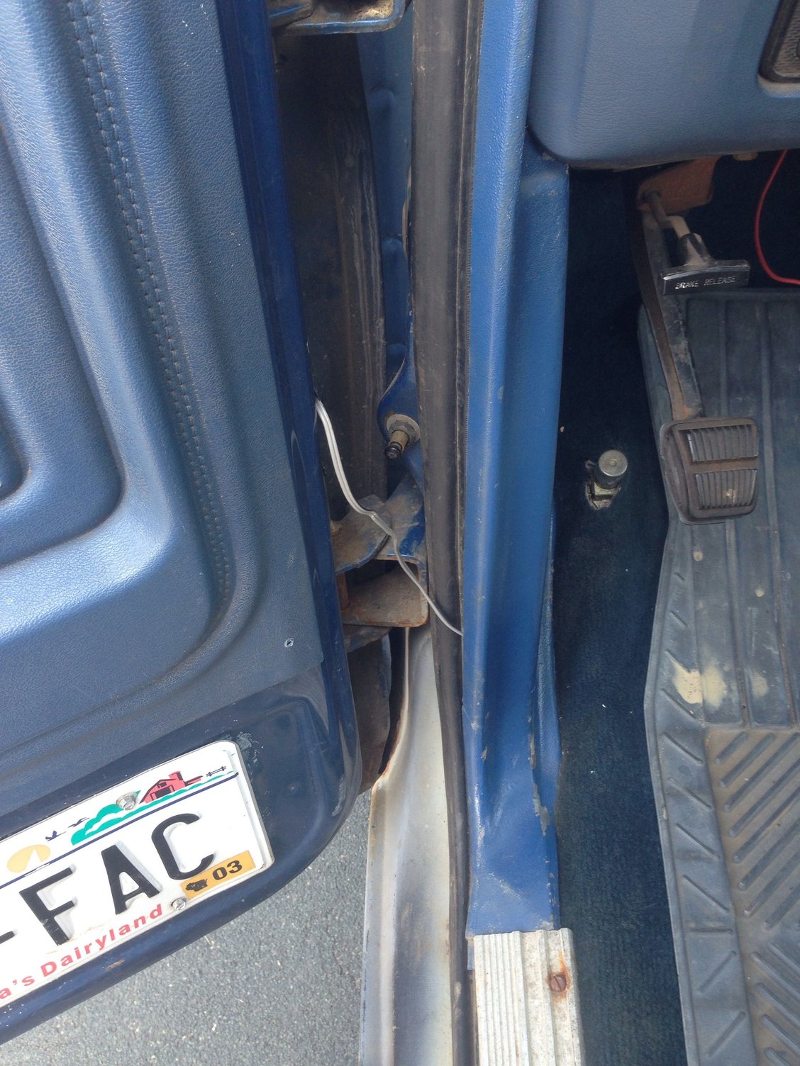

How did ford route the speaker wire from the doors? I can't find any holes in the cowl area for it, and I am currently running it behind the kicker panels.

Your truck most likely only had a "mono speaker" radio using the speaker at the center of the dash. Upgraded models with stereos (AM/FM Cassette) had speakers in the doors and there was a wire pass-through in the door (see photo).
