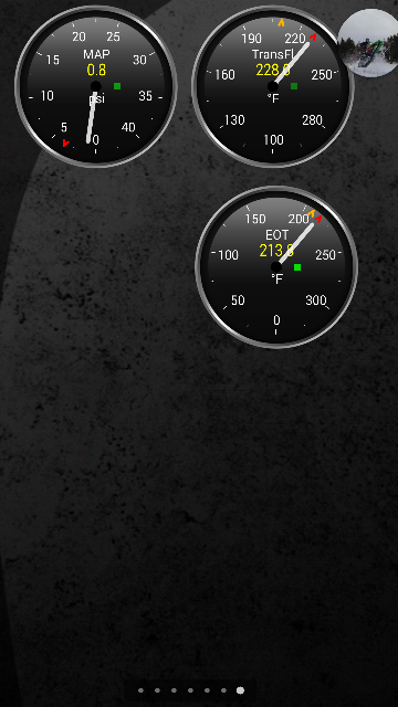

I agree. I puckered at 228* a bit. Slow windy steep hills. Not towing but ambient temps were 110* and it was a lot of low gear steep driving. Once it hit 228* I pulled over and took some pictures to give it a break. Dropped 50* in less than 10 minutes. Went back up but at least the old dog had a break!
At that temp I do keep an eye on the temperature.
You can safely run as high as 220F ALL DAY LONG and not cause any transmission problems. You can go as high as 250F for no more than a half hour without causing any problems.

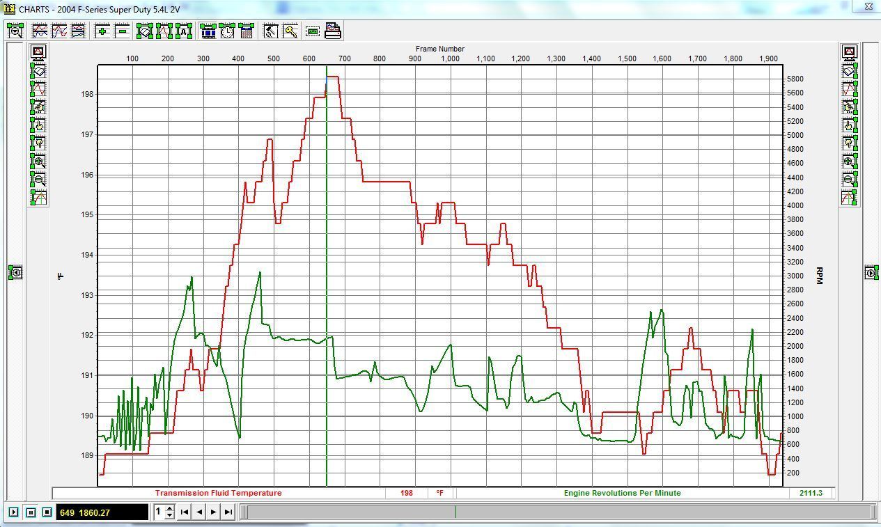

Here is some data collected on fleet customers 2003 F250 4x4 5.4L 2V engine, 140,000 on the odometer, truck is loaded with utility bed and has hundreds of hours of idle time. The customer concerns are "soft engagement from Park to 1st gear". Transmission will need Rebuild.
Data was recorded under normal driving conditions.
Outside ambient temp = 90 deg F
Relative humidity = 65%
Not exactly what you guys are encountering but relevant. Like Mike posted these units can take more heat than what is "generally" thought. I have recorded temps in 220 deg F-230 deg F in 4x4 Low on soft terrain. Truck operating under those condition for hours and no problem.
What I have experienced is operating in 4 Low on soft terrain is one way to push transmission temps into the upper end of the operating range. Seems to heat the unit faster than towing.....just an observation.
