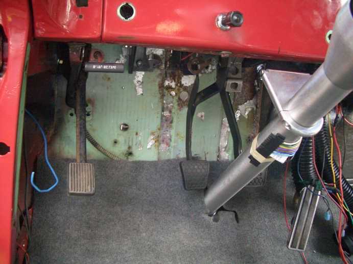

Be sure column is genuine Ididit or flaming river. There are some cheap Chinese clones being sold on ebay that have plastic parts inside that fall apart. NOT something you want to have happen!
Also you'll need column drop and floor mount, adapter for wheel of your choice if not GM mounting pattern, (My Grant wheel came with an adapter, but I didn't like the fit so I ordered one from Ididit). floor cover plate for Toy box (I still needed to modify hole column went thru to fit column, fill underfloor brake pedal arm hole, I have hanging pedals.
These are the only pix I have handy:
Shows floor plate and upper portion of column drop sticking thru dash extension.
test fitting column before dash extension
