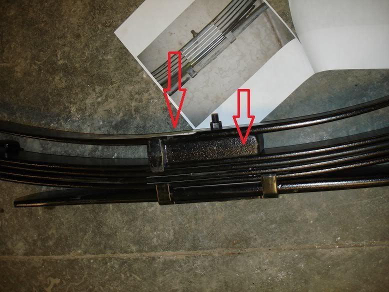

Originally Posted by 02expy
on top of my superduty rear springs and all i have seen they have 1 leaf on top of the pack that when loaded heave the end of the springs contact brackets on the frame to help with load carrying ability,
do i keep these
No, those need to be removed if you are putting them on the Excursion. They get in the way of the AC lines on the passenger rear side. When you do a search for the modded B-code springs you will see a sample of that spring getting removed and the spring pack modified with with leafs from your original excursion springs.
