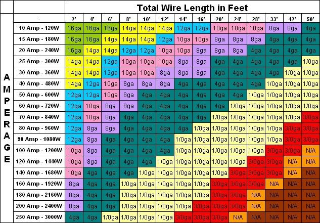

The placement of the fuse in question is on the 6 gauge wire coming off the batteries and 6 gauge then going onto the 12 volt disconnect switch.
I am not an electrician. Is this wire adequate for an 80 amps fuse?
Depending on the length, you should probably be okay.. Check this chart out below..

Must be 4 gauge not 6.
