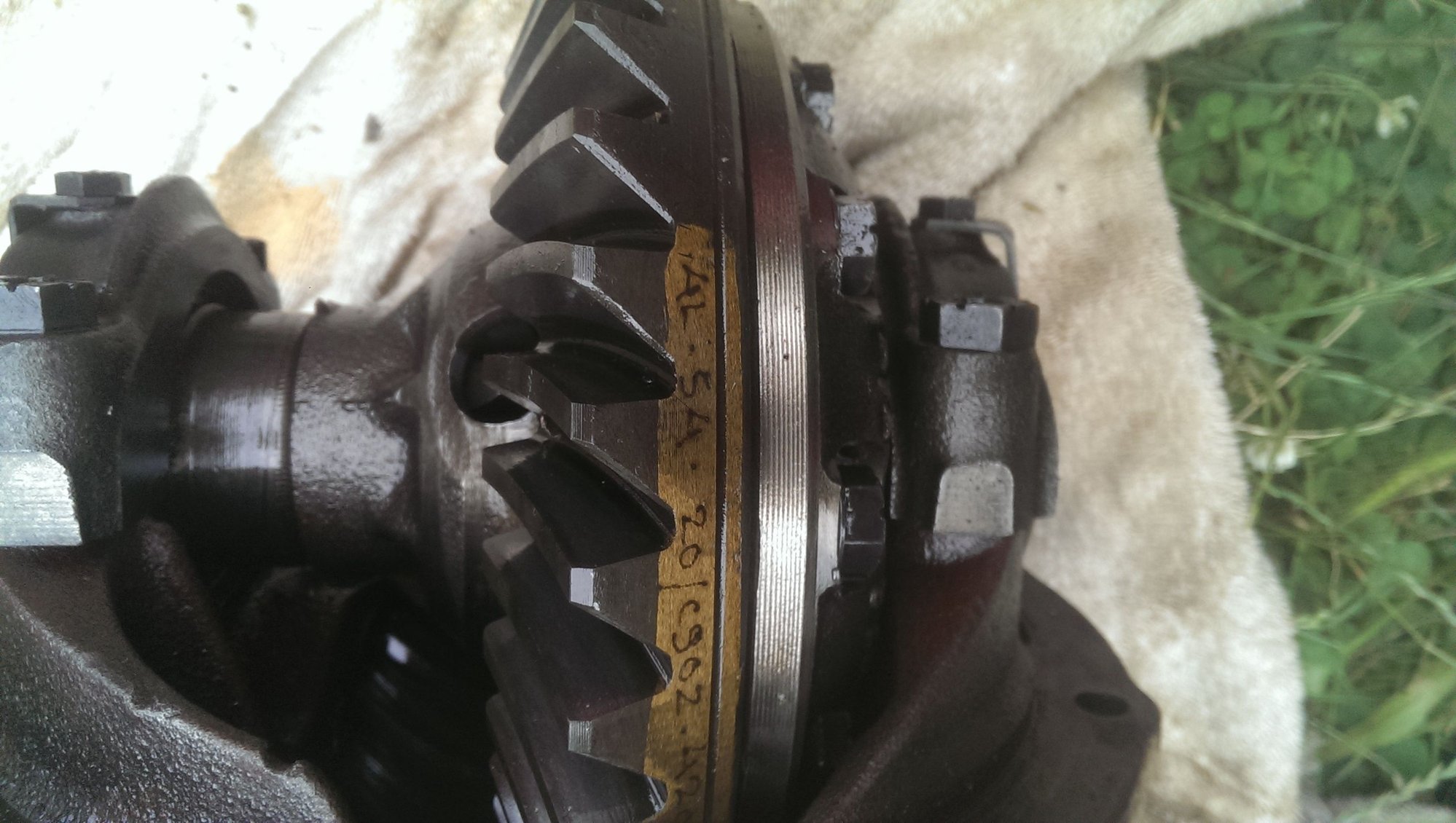

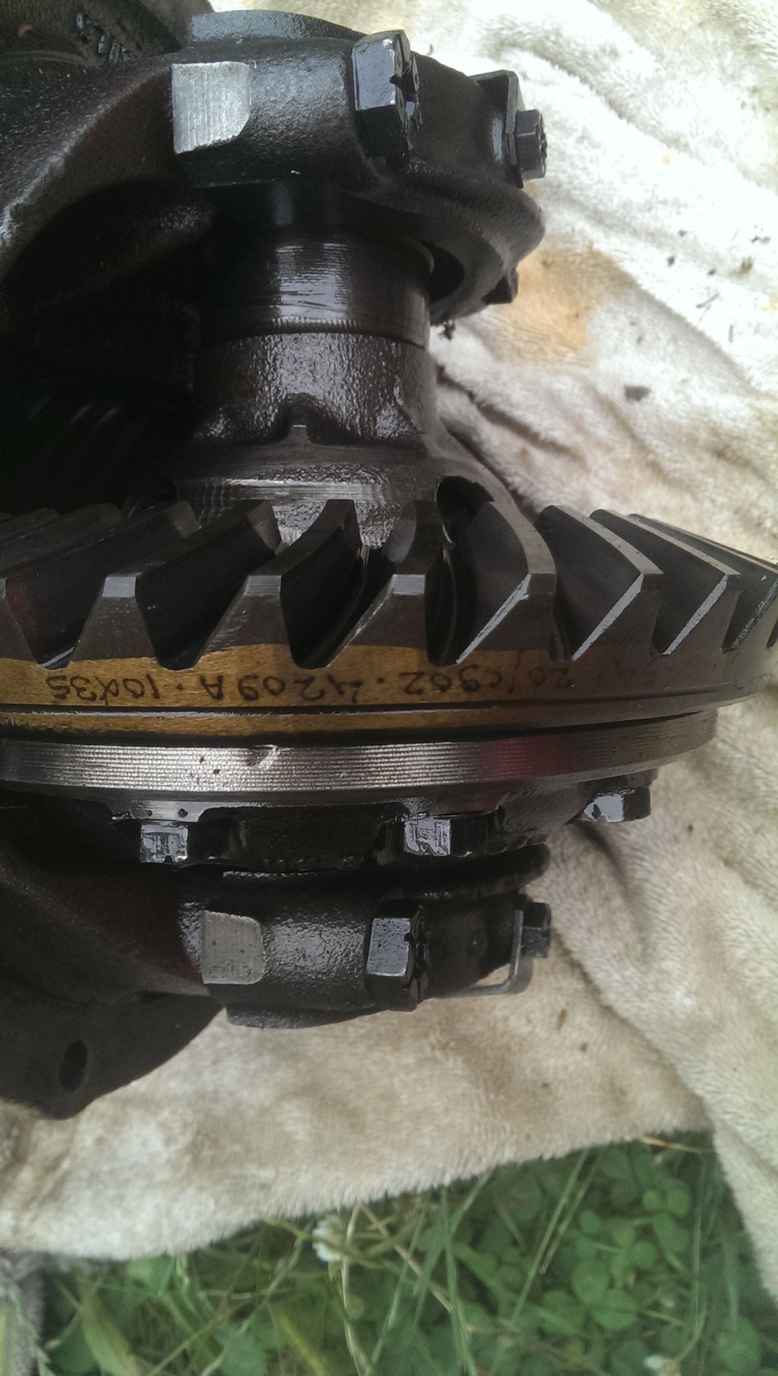

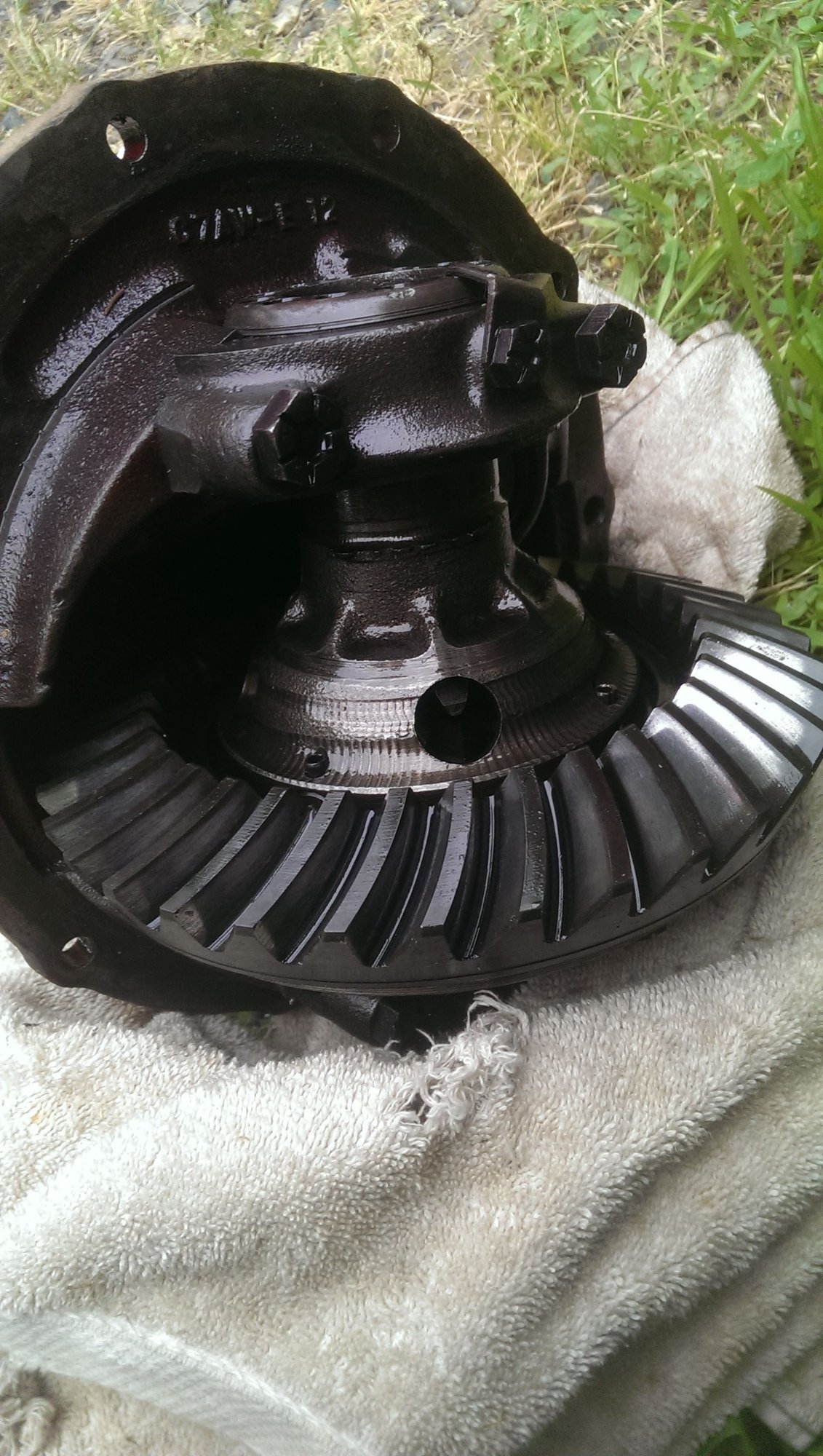

The ring gear looks fine to me. How does the carrier look inside? Any large chunks of metal in the housing? What condition are the axle shaft splines in?
Old Jul 11, 2014 | 11:02 PM
Buggz_14's Avatar
Buggz_14
Joined: Jan 2014
Posts: 109
No metal in housing and axle shafts splins are good. Honestly it looks pretty good. Idk what could have been grinding.

get a pic of the pinion gear
Old Jul 12, 2014 | 12:08 AM
slowrollerzcustoms's Avatar
slowrollerzcustoms
Joined: Jul 2014
Posts: 107
From: Herington KS
also on the front of the pig is there a N stamped in it

Before You pulled the 3rd member did you check to see if the stub shaft was spinning in the slip yoke? Might just be stripped. Happened to me in my 79 years ago under similar circumstances.

Which one is the pinion?
Old Jul 12, 2014 | 09:10 PM
  #30
OldMetal's Avatar
OldMetal
Joined: Feb 2008
Posts: 640
From: US/Baja border
The pinion gear is the one thats goes through the housing and connects to the drive shaft, the ring gear is the round one that the pinion turns.
What do the splines look like on the axles? The thing is if something is wrong in there you should be able to see it!
