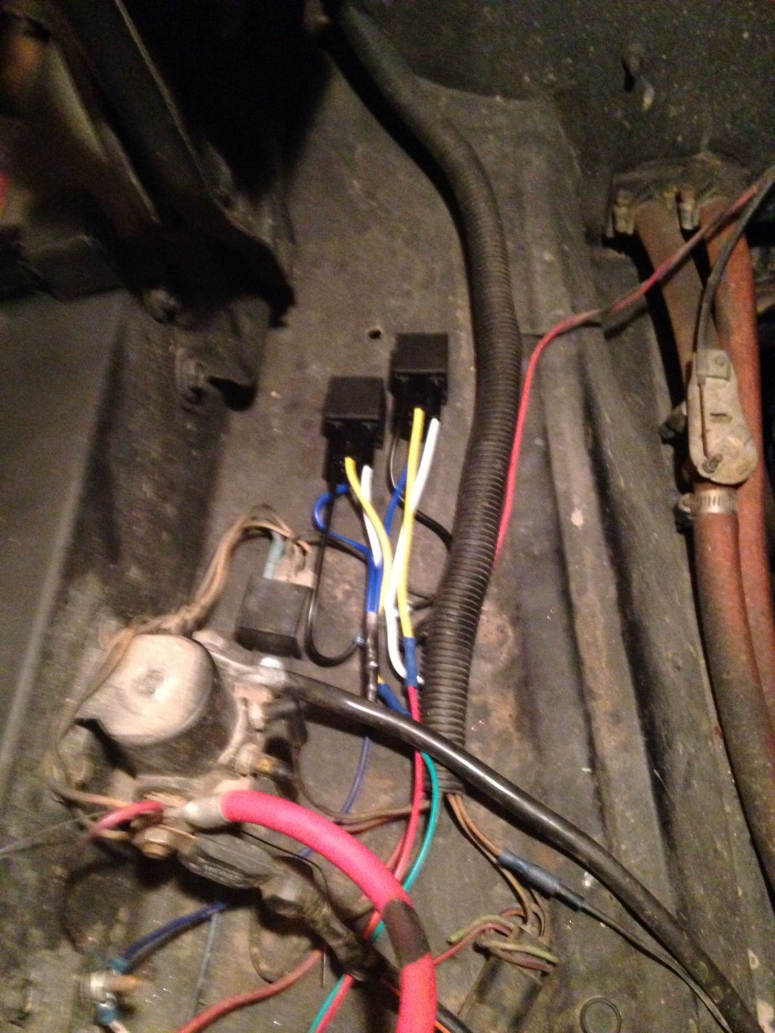

Ok, time has come and gone.
I tried the LMC harness, what a total POS that thing is....
I replaced the headlight switch. That solved the problem for a few months. But now it's back.
I bought some relays to use, but I'm trying to figure out exactly how I want to do it. I'm not a fan of the way explained above. Too complicated.
I've got an idea of my own that I think will work very well, and is simpler. I'll keep you all posted.
Old Jul 10, 2015 | 04:11 PM
351Cleveland C4's Avatar
351Cleveland C4
Joined: Jul 2011
Posts: 8,679
Likes: 191
From: On the Edge of the Desert
Headlights blink out.
Oops, forgot to update this....
Anyway, I got them rigged up and working well.
I have a 30 amp circuit breaker mounted next to the starter solenoid for my trailer brakes. I have a short piece of 10ga wire bringing power to it. I got power for the relays off the hot side of that, 1 14ga wire split to both relays (since they arnt on at the same time)
I used the original passenger side wires for the triggers, (obviously)
Then ran new 16ga red and green wires to each headlight, with the driver side routed over the top of the core support in a black sheath to hide it some.
