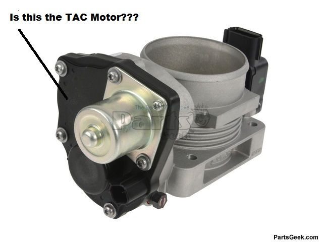

Yes, I see where I went wrong. When I originally read the manual for the scanner, I thought the first digit after the letter was a generic letter... my bad. So you are saying that the computer is bad, or the throttle body?
Is the TAC motor the electronic unit attached to the throttle body opposite of the TPS? If so, is that a replaceable part or do you end up replacing the whole TB?

Can anyone confirm if that is the TAC motor attached to the throttle body? And so, if what was said earlier is true and most likely my problem lies with either replacing the throttle body or the PCM, I assume the logical choice would be the TB first seeing that it's a bit cheaper to replace? Keep in mind I already replaced the TPS and that didn't do it.

Yes, that's the TAC motor.
