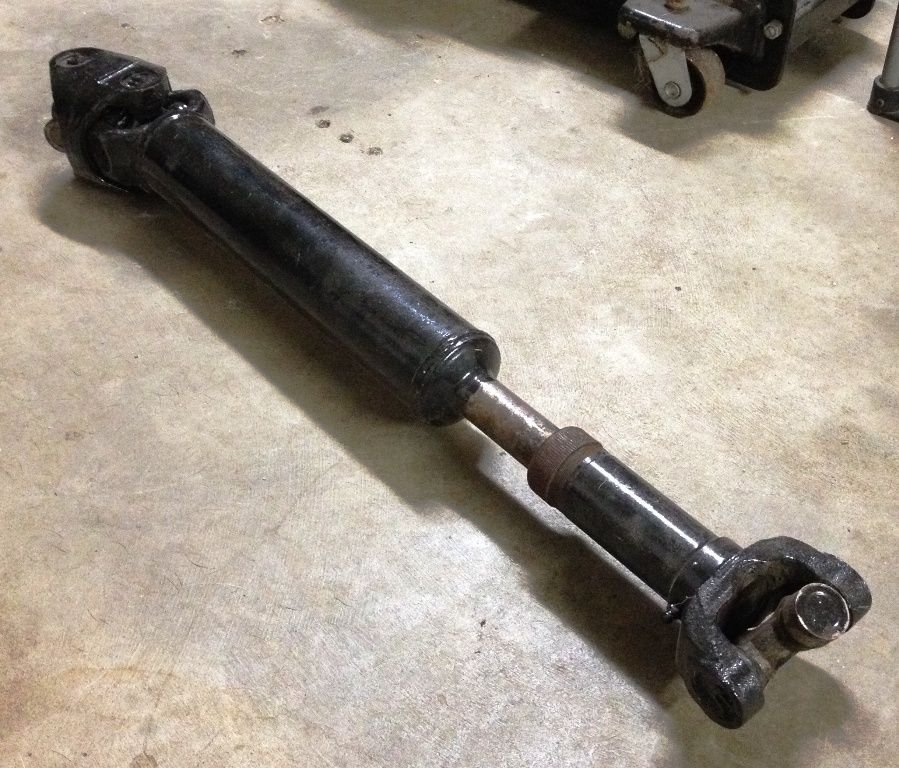

Front Drive shaft:
Here's what mine looks like. I'm thinking it's the factory piece. I did not take measurements and obviously its not installed.
Actually now that I re-read your post I am thinking the engine might pull that transfer case down. My memory says its heavy on the tail end and it will sit back quite a bit. If your suspension is fully extended then that might spell worse case scenario. Are your shocks installed?

2x.... wait til the engine is installed before raising the alarm on the front driveshaft.
Also, you should also be aware that a longer rear driveshaft and extended length brake hoses are required with a 6-inch lift.
In principle, 1/2 or less of the slip splines can be exposed with all of the weight on the ground. Again, ya won't know that until the rig is fully assembled. That's the main reason the driveshaft(s) are one of the last things that are fabricated or modified as part of a build.

6 inches is gonna put the driveshaft at max exstention for normal driving. I'd wait till you get it all together then have the shafts lengthened accordingly. And I'd recommend not to go with a longer splined shaft. It'll twist like a candy cane if your putting any serious power to the wheels.

My stock Scab ds was about 2" longer than the one from the F350. I plan on swapping back to it to see if it's long enough. If it's not, I'll just have one of them lengthened.
