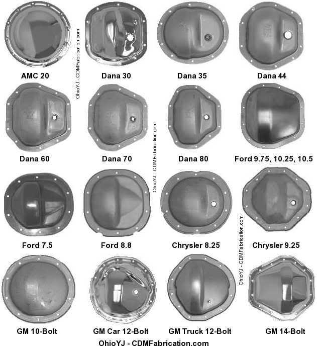

According to this "chart" I found and your photos, sure looks to me like you have a Dana 80 in your truck. Hope this helps.

That Dana 80 inspection cover looks nothing like the OP's, as it's taller and narrower than the inspection cover in the OP's pic.
How the hell could the OP use his 5 lug, 5.50" bolt circle wheels on a Dana 80 that came with 16" 10 lug wheels on a 7.25" bolt circle?
Here's the Dana 80...does it resemble the rear axle in the OP's truck? Not to my eyes it doesn't.

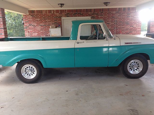

ND - I did not know it has 5 lug wheels. I was only going from the photos and the 80 stamped into the casting which according to Dana Spicer indicates a Dana 80. As you know, all sorts of mods have been done to these trucks over the years, including the Crown Vic swaps, etc. Below is a pic of a supposed 61 with 8 lug wheels. Now I'm really interested to see what axle this is as Im sure you are as well.

It is a floater. Sorry for the miss info. I haven't had it apart in years and have had so many others apart lately I just miss remembered. I hate getting old.
The vin plate says the truck should have a 9 inch with 3.0s in it (A1).
So some PO must have stuffed this older 80 into it. The front is 5 lug.
My question now is, when did Dana start making 80s?
And why is it an 8 lug instead of ten?
