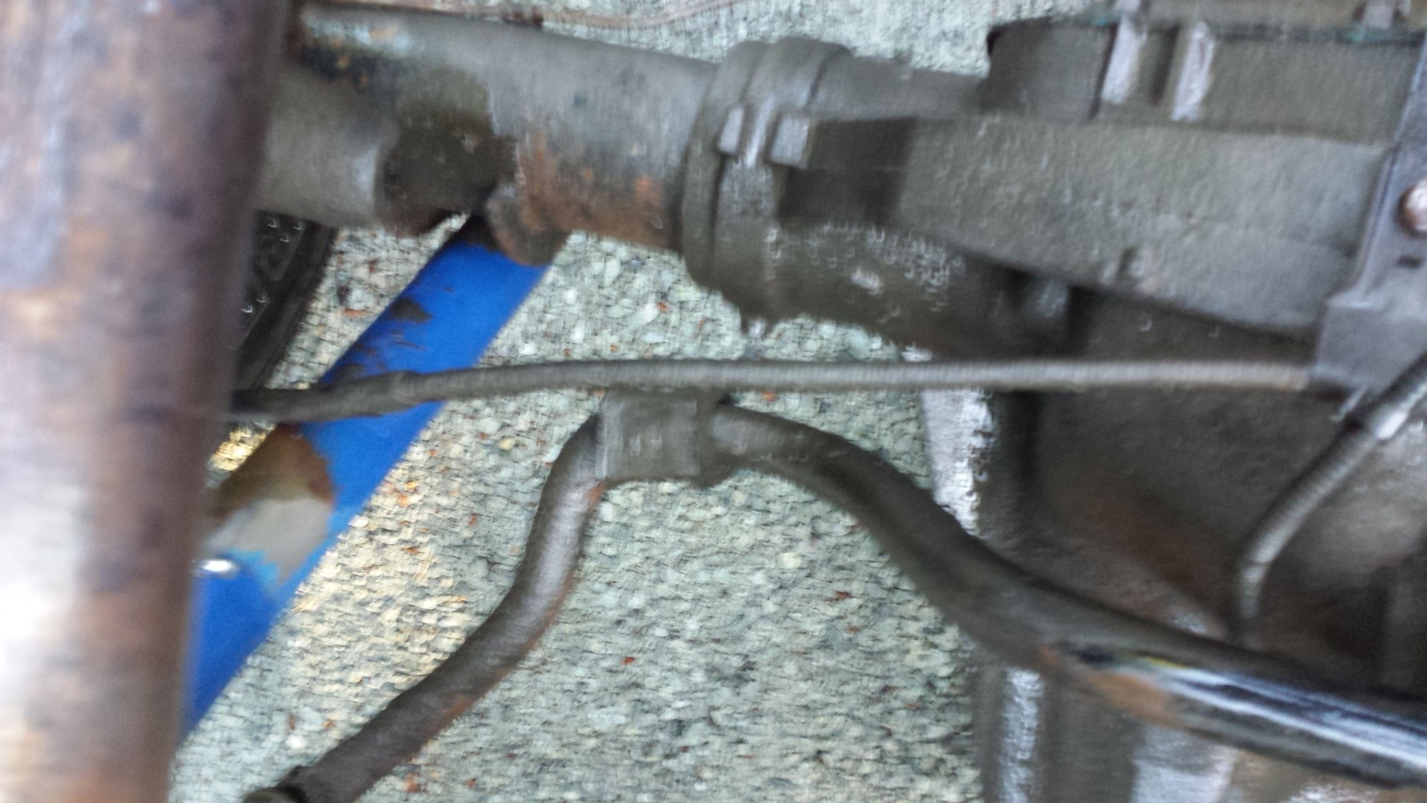

Hi All,
1995 F350 Powerstroke automatic. I have the bed off looking down at the differential. There is a bar that is bracketed on both sides of the differential on the axle. The first picture below shows the whole mechanism (with the broken part on the left
of the picture, the second shows the good side attached and the third picture shows the broken one.
Thanks in advance!

sway bar bracket/mount. Not a big deal you can just remove the other side and run without it.

Stabilizer bar bracket. The U-bolt must've broken, and all the good bits fell to the ground. Only part left is the bushing.
