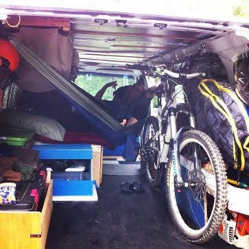

did interior build out complete with bed and storage options. currently live in this 5 days a week as a guide and trail builder and part time sawyer and bang some nails too etc.

The only solution I have found is to keep everything portable. A 4x8 sheet of plywood that fits in any Truck bed or Van with 2-2.5 foot high sides with a (any size) removable multi hinged top for a mattress foundation. It's just tall enough to hold 20lbs Propane tanks, Water tank, Battery bank, Stove, Buddy Heater, etc. It could slide from one Van to another or even be set off on stands and covered up. Add a 12v line and a portable Solar Panel setup and your done.............

You got it man! that is what i have for bed and then the storage underneath..everything on this build is modular..it can and will go to later vans down the road..maybe a big Transit..i can dream!

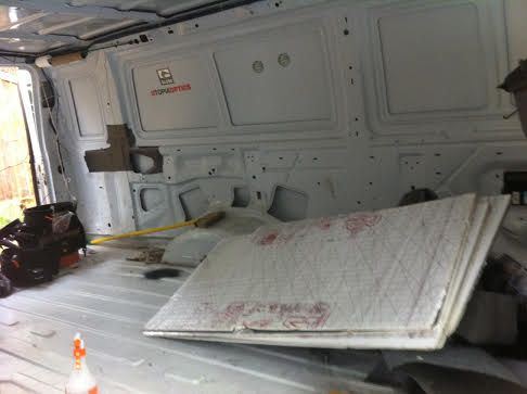

I have a good bit of experience with the floor rust you show around the dog house............
That's caused by the OEM mat padding absorbing moisture in the form of humidity----our bare uninsulated vans sweat, the moisture accumulating in that padding. It seems that material easily absorbs the moisture but never leaves, the result being the inside floor pan is constantly wet which leads to the rust.
I purchased an '03 cargo-only E250, upon first inspection the rear mat was thoroughly soaked, early signs of surface rust over most of the rear area. Flipped the mat over to dry but a week later it was still about half soaked. Another two days laying in direct sunlight finally had it completely dry but it was never returned to use---its still laying rolled up on my protected front porch.
Removing the seats and front mat found a similar situation---time for POR-15 treatment of the entire floor pan. After proper application a foil-backed radiant barrier insulation was glued in place up front, the by now dried front OEM mat re-installed. The rear area received a bare 3/4" plywood floor with heavy duty commercial great carpet over that.
Long story short don't use anything absorbent under the OEM mats OR completely treat/protect the existing floor with something to at least slow the rust process down. I have before/after photos of my own van if interested. If you already have the new flooring in place.............never mind!

absolutely right, i tore it all out and replaced with a different kind of vapor barrier etc foam and plywood combo, thank you so much for the feedback!
