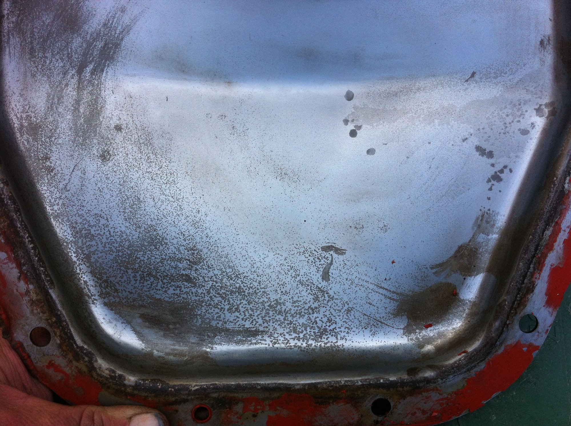

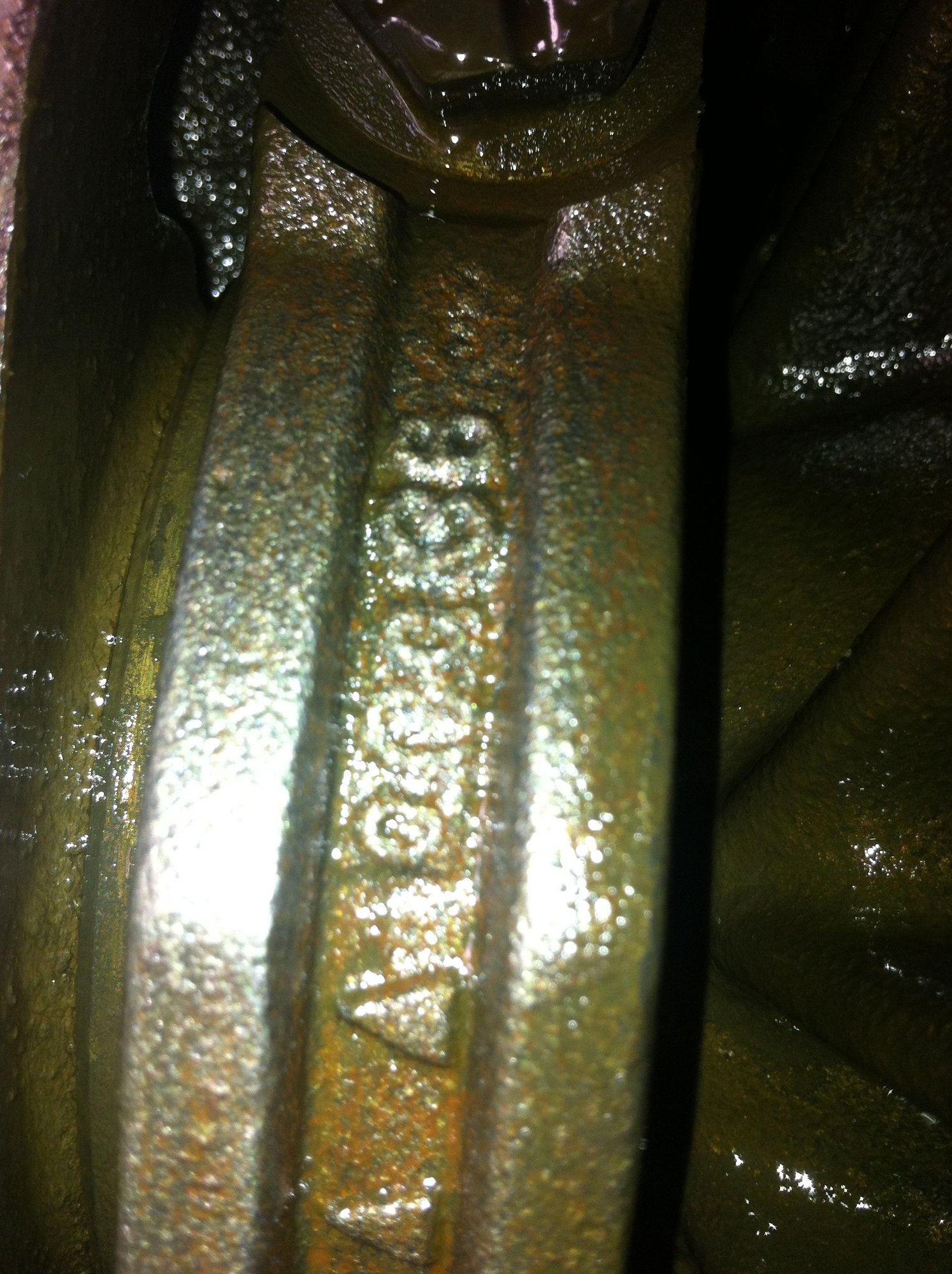

New-to-me e99 F350, 4X4, SuperCab, Long Bed. Removed rear diff. cover, drained, cleaned mating surfaces, wire wheeled & painted cover, new UltraBlack RVT, refilled.

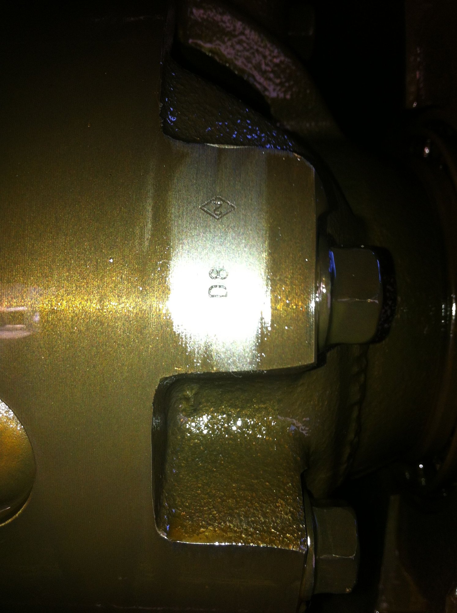

Door sticker says non-posi. "Axle 41"

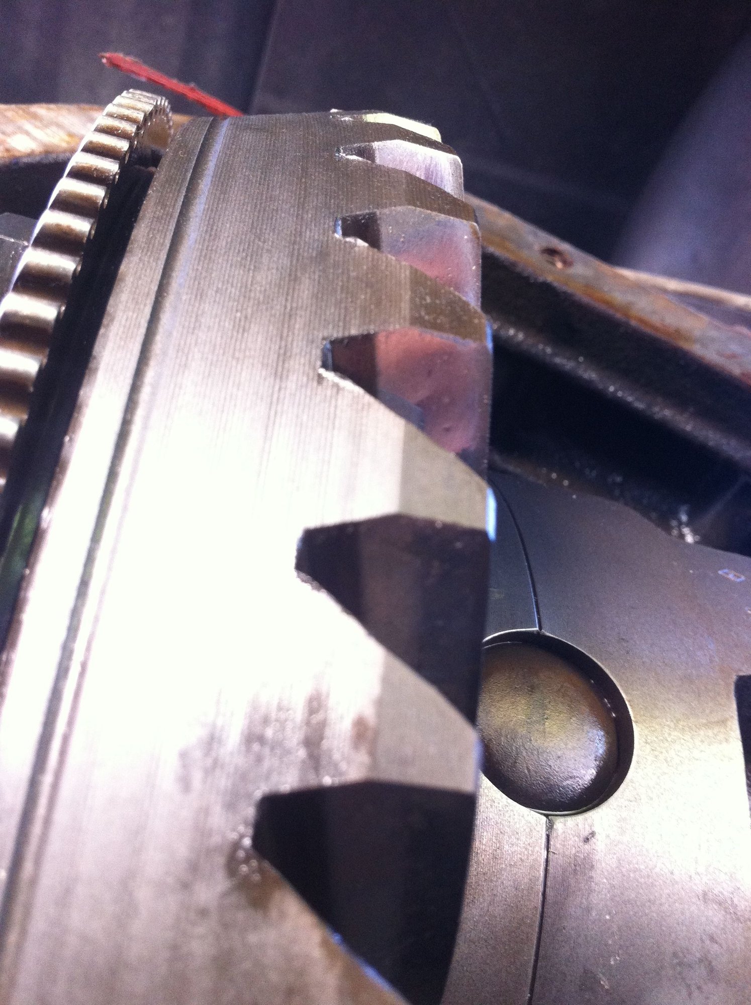

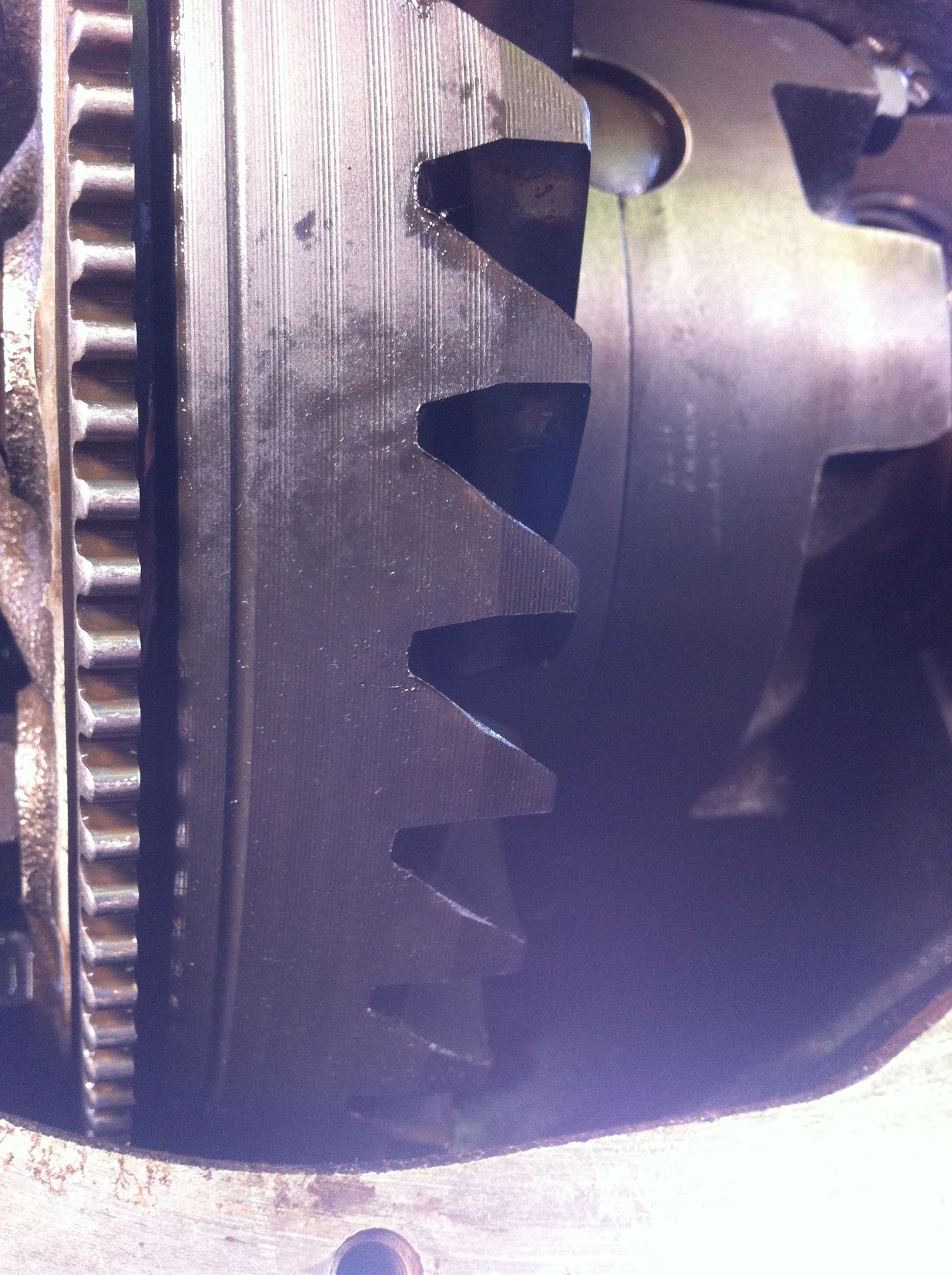

How's the condition look?
It's the 10.5, right?

The outside of the cover had some shallow pitting and at a certain point I didn't want to take off all the metal around it with the wire wheel.
The inside was discolored and had some pitting on the inside radius edge.

Looks to me like you have a locker in that.

Is it the original rear axle? Don't quote me but I think the OEM Sterling rear end was a 10.25 until around 2001 give or take. Hopefully somebody will chime in and correct me if I'm wrong.

99 or 99.5 is when they changed to 10.5"

It very well may be a Limited Slip differential. I would be cautious on using the friction modifier. A simple way to check the differential is jack one wheel off the ground and see if you can turn it with it in neutral. Chock the wheels first to make sure it doesn't roll away! If in fact it is a L.S. differential, Guzzle has a good recommendation on how to use the Friction Modifier.
It's an early '99 - Door sticker production date, 04/1998. I think the owners manual says 10.5? Hmm.... I'll have to double check......
So, I'll get either of the rear wheels (but only one) off the ground, have the truck in neutral, and attempt to turn the lifted wheel. If it turns, it is NOT an L.S. and if it doesn't it IS an L.S. ie, If it's L.S. the wheels are "connected," correct? Oh, and I won't bother chocking the wheel, I live on a hill. What's the worst that can happen?!
So, chocked the front wheels, jacked up the driver side rear, put it in neutral, and the wheel turned freely. Repeated the same process on the other side, with the same result. Looks like I don't have an L.S. diff. I did put about 3/4 of a bottle of friction modifier in. Anyone have experience with that being an issue?
Thanks for the heads up about the testing method!

The Ford limited slip has clutch discs. They are kind of similar to the friction disc on a manual transmission clutch.
How it's supposed to work; when you are driving down the road the clutch is engaged, supplying equal amounts of torque to both wheels. When you go around a turn(with good traction), the torque difference between the 2 wheels overtakes the friction between the clutches and the wheels are able to spin at separate speeds so you go around the turn smoothly(with out the wheels hopping). Sometimes the friction modifier is needed to make this happen. So the idea is, in a low traction situation, the clutches will limit the amount of slip between the two wheels and supply some traction to the wheel that would otherwise be free spinning.
In an open diff, there are no clutches, so no need for the modifier or any other special gear oil for that matter. Yours does not look like an open diff in my opinion.
