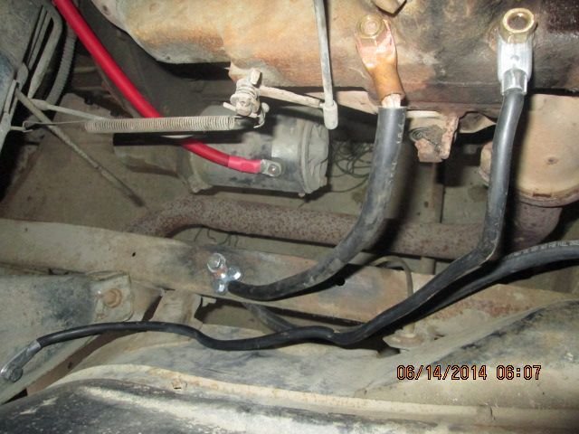

Does the ground cable from the battery go to the block? It should.
It does. And the new one I installed goes from the manifold on the other side of the block to a bolt through the frame (#4). Is the solenoid enough to ground to the cab as you mentioned yesterday? I don't have anything from engine to cab currently. Thanks,

No, you need another wire, probably a #12.

Ok, can I just use the same spot on the manifold and run one to the frame and another to the cab then?

Here is my current set up:
Battery grounded to block, positive to solenoid. Solenoid to starter.
Manifold to bolt (underside) on frame.
Sorry I couldn't get these to save the right way, but if you're flexible you can see what I'm talking about.......
I'll add one from the manifold to the cab (unless you have a better suggestion).

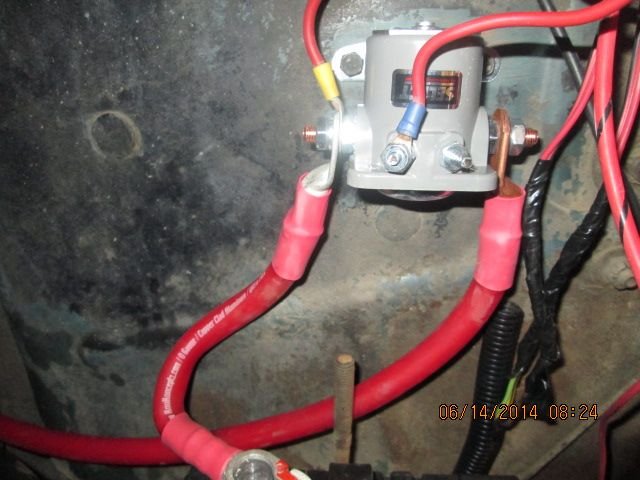

Ross, or anyone else for that matter; have you seen a solenoid like this. the company I bought the "kit" from sent me another solenoid the other day and it wasn't like the first. It has the I terminal, which is no big deal, but it also has this little jumper wire. I'm not sure if I should leave it on or not. I'm also unsure on which way it even mounts....... The terminals aren't marked and plently of google searchers have yielded little. When I mount it with the writing right side up it appears upside down as far as terminal location and outside design. Any thoughts? If not, no big deal, I'll just hook it up and see what happens. I will likely not put in the jumper wire on the first go around.
I'm also installing new cables size #0.

I would call the "company" that sold it to you. Experimenting with battery voltage is a sure way to end up with fried wiring or worse. It is odd looking anyhow. I'd send it back just because of that.

Ross/others! OK, so I bought a new solenoid today and got it all hooked up.
4 terminal but not using I post
It's starting great for now!

I ran all new cables and added a ground from the block to the cab #4. I also made the one from the block to the frame #0.
Congratulations
That solenoid looks much better.
