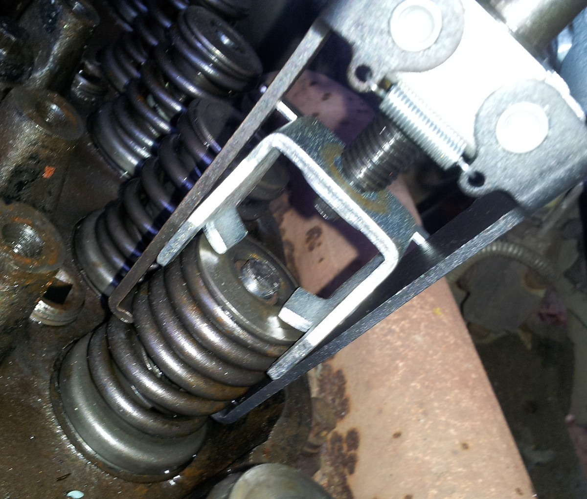

Got a possible problem. Using the Harbor Freight spring compressor per instructions and the keepers are not coming loose. I removed the tool and lightly tapped around the retainer with a rubber mallet, then tried compressing again. Same thing - keepers seem stuck to the retainer.
Help, anyone?

move the piston to top dead center or close. the he valve will stop moving to pop the retainer loose

That is potentially bad advice to hand out. Hammering a valve loose with the piston at TDC will cause major problems since there isn't but a 1/4 inch or so of clearance between piston & valve. If you have it at BDC, the valve keepers could bounce out and the valve drop into the hole.
I got the keepers unstuck by soaking in kroil overnight & lightly tapping with a metal hammer & socket. They clicked right out with a magnet.

Pop may have been the wrong term to use, very gently tap with soft hammer or your fist. I don't like the piston on the bottom just in case you drop the valve and it falls in then you have to pull heads.
