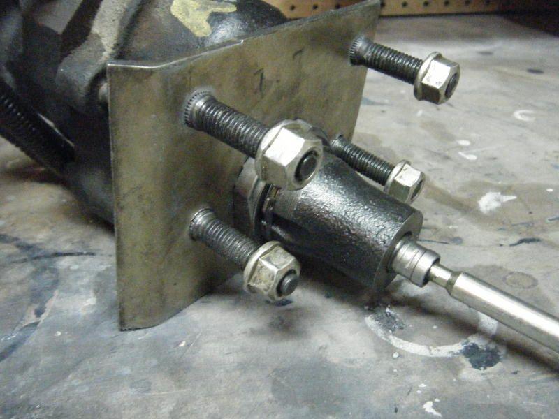

I used a generic adjustable valve. They are all pretty much the same, once you step away from stock applications. I think mine was from Summit and says nothing on the side.
Bullitt390, how do you get those axle shafts in and out? Maybe there's a difference in the axle flange between years, but I'm running front Jeep rotors and mine came with an off set hole drilled in the middle-ish for getting to the flange bolts.
It's been a long time since I've pulled them, though, and it's early, so maybe I'm seeing things wrong...
Here's mine:
