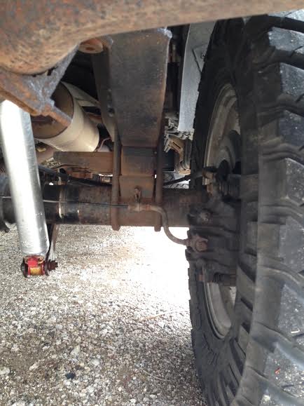

Yeah my Ex has a forward rake. Here's a picture of the rear suspension- the leaf spring block on top is about 2.25" tall- not sure if that's a factory block...
I don't like the forward rake I was hoping to remove the block and still use my Rancho's that were made for the 4" lift.

I am not sure about the shocks, but you should be OK with getting rid of the blocks. I am running 35's on my Ex, and the 4" lift is perfect. Good luck with your project.
