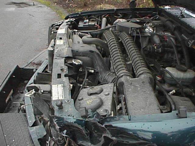

Originally Posted by rla2005
The OP's truck has only one O2 sensor.
Since we already know the vents are cycling when accelerating that implies there is a vacuum leak in the intake system. Unmetered air is translated as a lean condition by the O2 sensor so the computer keeps dumping in fuel.
Well that may depend on a few things.
I may of missed this but what engine and size?
My 1995 F250 with a 351 had 2 or 3 O2 sensors. It would test out as a bad sensor and replacing
then did nothing to solve that problem. Sadly I never fixed it do to totaling it shortly after that.
Sean

Having to think back to before 2000 and I am starting to
have some things come back. My truck did have 2 O2 sensors
and did not have Mass Air flow.
Now mind you the truck came down from Canada.
But I do recall replacing all 3 of the O2 sensors on that one do to the cost
and locations
Sean
6.0L Tech Folder

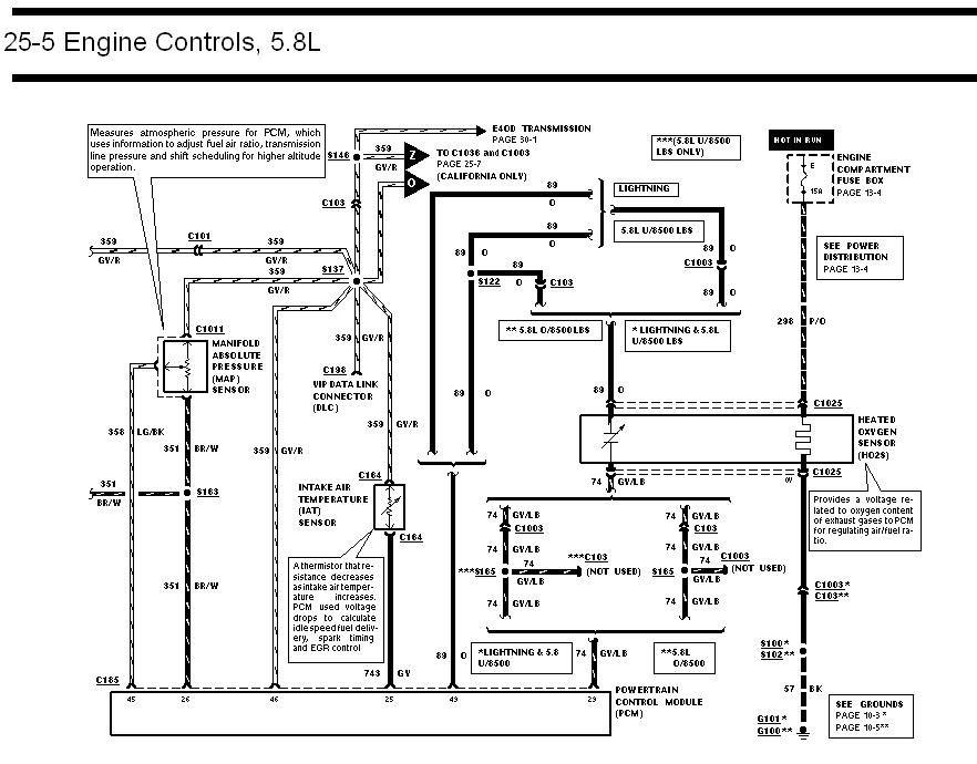

Federal emission F250HD/F350 trucks in this era have one O2 sensor.
1995 F250HD/350 Engine Control w/MAP & 1 O2 Sensor
It was NOT a US truck. It was from Canada.
It did have more than one.
However we are getting way off track here with this little debate.
Sean
