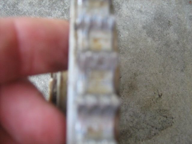

update
I figured out what was wrong. My timing chain was a tad loose.
The plastic/nylon teeth were all gone and it looks like it had just been the aluminum gear for quite sometime.
It's hard to see but some of the teeth are really worn down. I've had the truck for 2 years and put maybe 2k miles on it and never noticed any of the nylon pieces when I changed the oil.
I put in a true street cloyes chain and gears. It is running really well. Thanks for all the help everyone.
