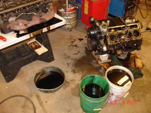

Just drained 25 litres of "oil" out of it. Walked away and left it to drain, and I have quite a mess on the floor, since I only put 16 litres in at oil changes. I guess I have my runaway figured out. Too late to drop the pan tonight, I suspect the crank is wiped out.
Now I have 8 injectors I don't trust at $400 each.
Sigh.
The 6.0 holds allot of oil that doesn't come out with oil changes.
When I drained mine I nearly filled 2 buckets.
