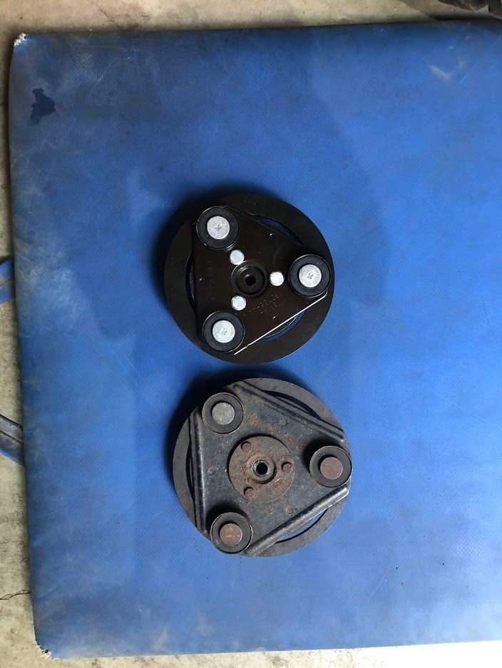

Old Jul 4, 2022 | 05:26 PM
Lance990's Avatar
Lance990
Joined: Jan 2016
Posts: 209
It is the A/C clutch/pulley size. I accidentally ordered the wrong one and that's how I found out. I don't have the package but ordered the one with the package and the clutch hub was smaller in diameter than the one without the warm weather package. Hard to see in the top photo but the new hub is smaller than the one I needed.
