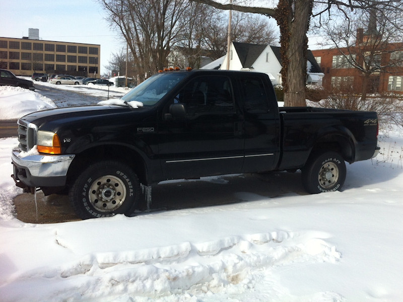

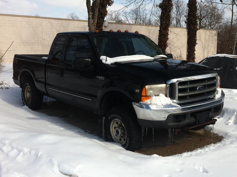

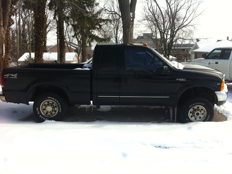

Here are a few pics of the truck before we aired up the tires.

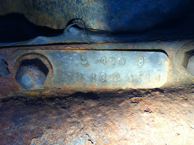

This is what the axle tag under the truck looks like.
I know this isn't the original axle, and I know that not too long after he swapped the axle, he blew up the T-case.
Soo... That is a 4.10 tag right? If this is what I think it is, it looks like I have my work cut out for me this spring.

Not 4:10 the number on the bottom left where it say 73 means it is a 3:73 gear ration, I cant tell from the tag but if it has a L in front of the 73 then it is a limited slip 3:73..
