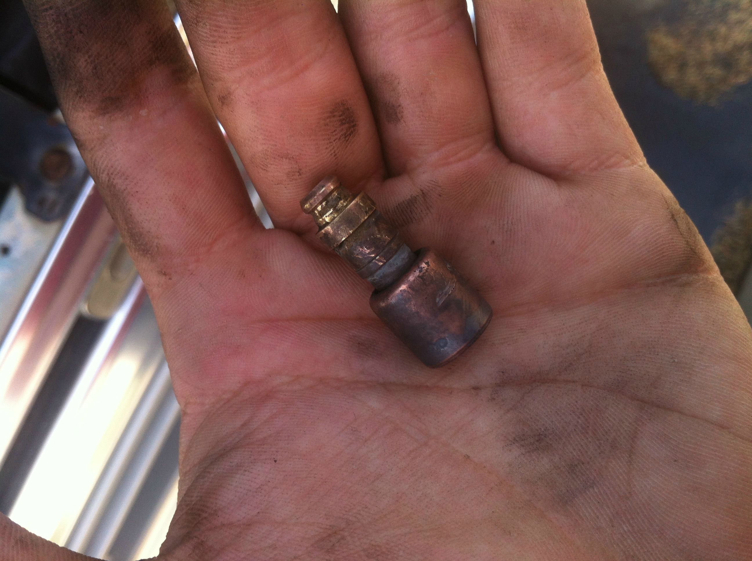

So I pulled the water outlet, to look at the thermostat, and partially to my surprise, I had no thermostat. Not really an issue here, as it never gets super cold.
However, under the water neck, i found this in the tube/pipe inside the block.
It looks to be a plug of some sort?

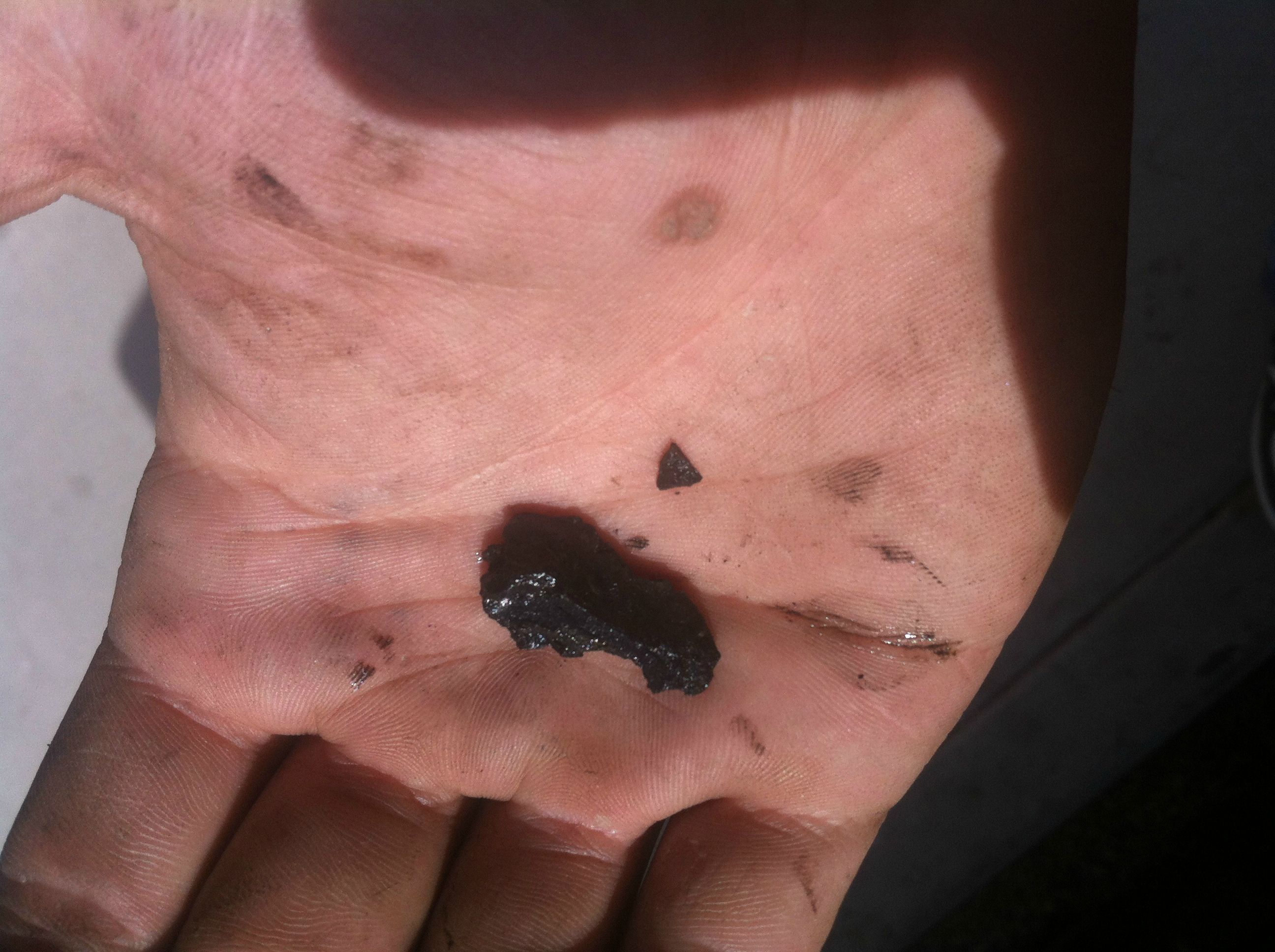

I also found what looks like gobs of coal, or some serious carbon deposits attached to bits under the water neck.
So, I think the first thing i'm going to do is a serious radiator flush. Clean water goes in, comes out looking like weak coffee
Old Feb 23, 2014 | 05:28 PM
gatorfor88's Avatar
gatorfor88
Joined: Jan 2013
Posts: 3,512
From: Panama City
That would definitely slow down water flow. You actually need a t-stat so the radiator gets a chance to do its job.

Looks almost like the center of a thermostat. Hard to tell the size on the pic though.

That's what my boss thought as well, the bottom, "plug" end is about 3/8" in diameter and about two inches in length.

Pretty sure that's whats left of your thermostat. The other stuff is whats left of the steel parts. Would certainly plug up the works.

I grabbed some bar stop 10 minute radiator flush, about the only thing auto zone had on the shelf, Flushed the engine, on draining it came out looking like watery chocolate milk, had been draining clear, so it got some stuff broke loose. put in a new thermostat and gasket, I'll drive her around for a while before work and try and get it to heat up.
