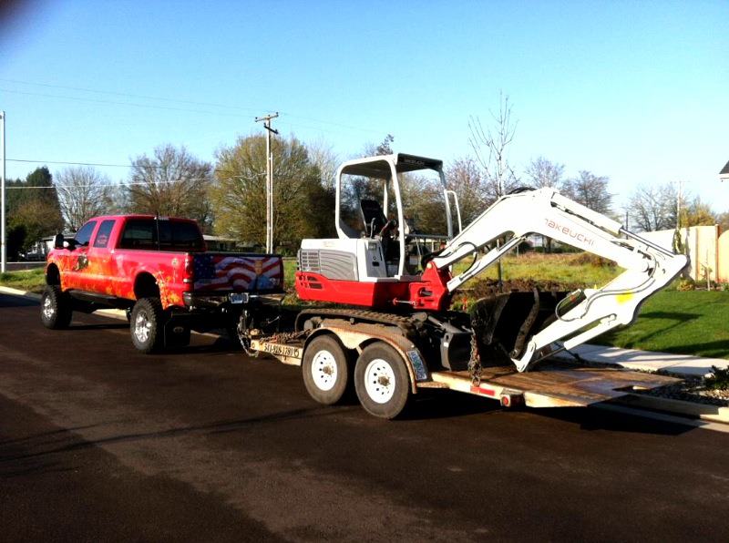

Originally Posted by kornfanjoe
I would be worried about towing capacity if you were to do something like that. I think a swap to 2005+ coil front suspension, with progressive rate long travel springs front and rear with shocks valved specifically for your application would be a big step in the right direction.
Towing isn't a problem.
Attachment 91963
Nice looking truck Mr Ice T,i cant wait to do the airbrush Ned kelly theme on my Ftruck..
