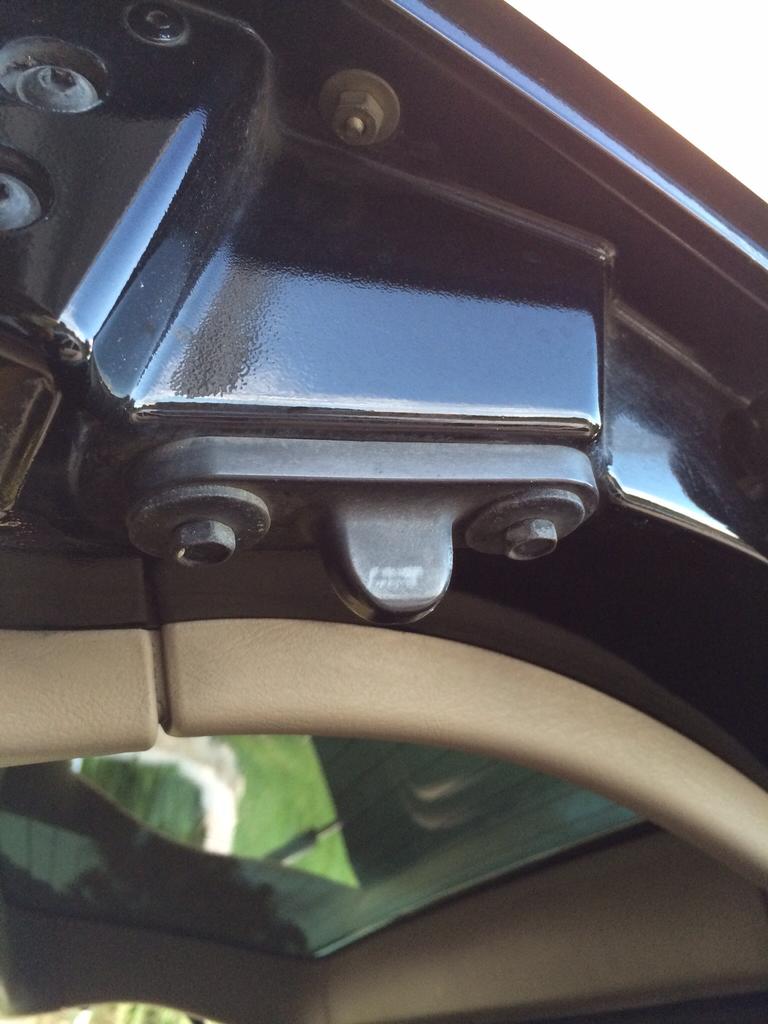

Spray it here and the female side of it too.
Attachment 91127
OHHHH that's where they are! I figured they were internal with the latches. Those just looked like snubbers or locators to me. I'll spray those today and retry.
Attachment 91127
...those are just the alignment tabs, there is no electrical switch on either end (try removing the two screws, you'll find no switch connections behind them).
The switch is integrated into the latch assembly. Hit it with WD-40 and open/close it a few times, rinse and repeat.
Really, that's where I was spraying my 02'. I must be just lucky I guess
...maybe the alignment pins were putting just enough pressure to make the switch freak out and the WD40 allowed it to seat with less resistance?
I know I hit the latch only (and the barn door latches just in case), did the open/close dance a few times, sprayed it one more time and it cleared the issue for me.
I pulled one of those off once to see if I could pass a wire through the body at that point and found no wires on the back of the female end.
