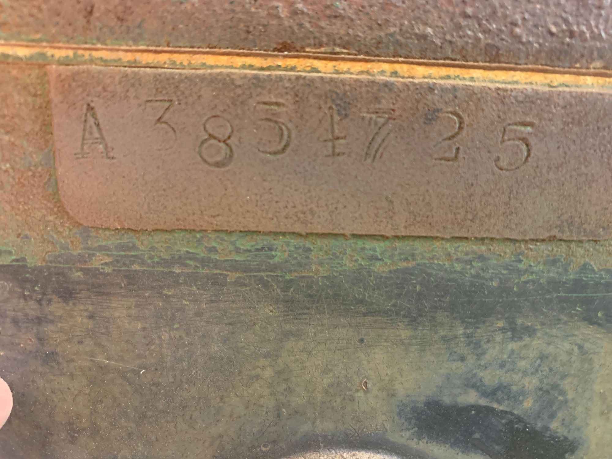

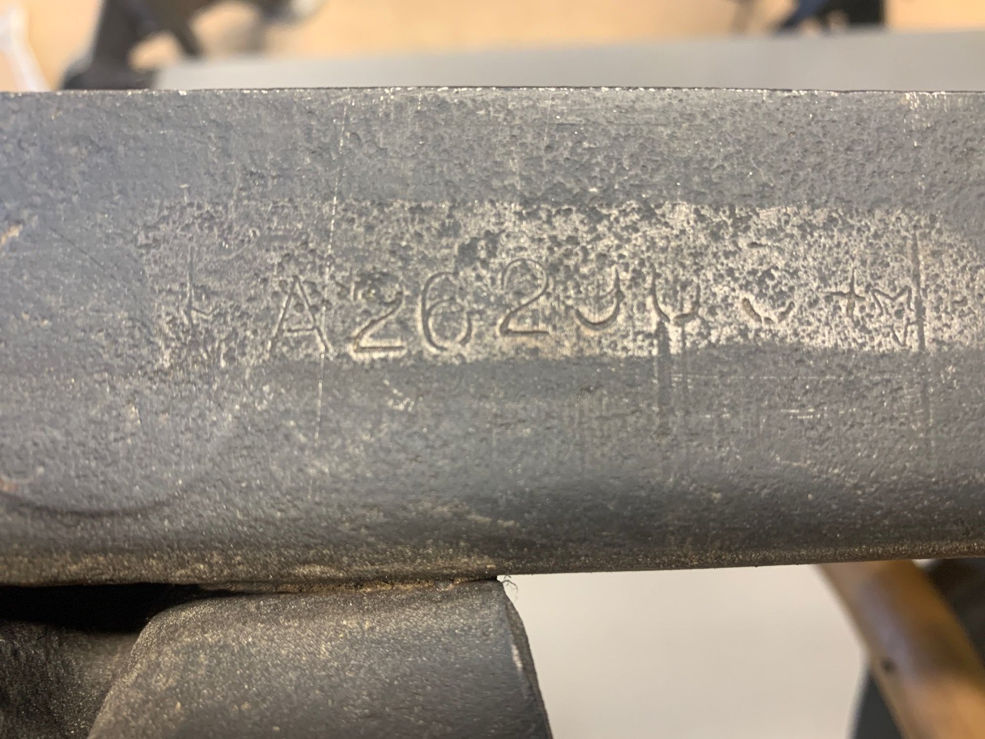

I am working on a frame up restoration of a 1928 Model A Pickup. You will find a "serial number" as they technically did not use VIN back then on the top of the frame, around a foot back from the Steering Gear mount. I your truck is not torn down from the frame, you will not be able to find it as it is under the cab framework. You will also need to use the Engine number if you are trying to get an exact date for the build. I am second owner so I have knowledge that the engine is the original so the serial number on the engine will have accurate information. There is a site on the internet that show the dates and location each assy was build and when. Hope this helps anyone that needs this type of information. I know you should be way past needing this infor but I put it out there as I knew nothing of the birthdate of this truck. Just an FYI there is a photo of this pickup being used to haul supplies to the site of our new Highschool back in the late '50s. Good luck on anyone working on a Pickup from this era. they were an extremely valuable tool then.

vins where stamped into the left frame rail near the firewall front leg and over the rear axle area,
