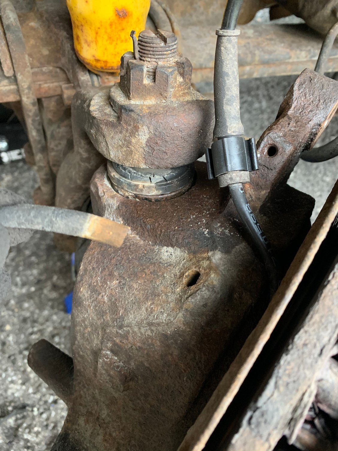

Originally Posted by Sader
I used a brass pneumatic fitting. 1/8" MPT x 1/8" barb
Been on for three years, no issues. Could probably find one at your local hardware store. I changed the line as well and secured it to the barb with a zip tie as well.
Cheers
are we talking about the fitting that goes in here
Old Dec 14, 2020 | 06:02 PM
Dweber85rc's Avatar
Dweber85rc
Joined: Mar 2019
Posts: 1,293
Likes: 164
Yes that is it
