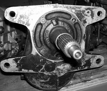

"What is a 350 muncie pattern? "
ummm.. I'm a ford guy so take this as a ford guy trying to explain chevy technology and terminology... when he doesn't really know a whole lot of chevy foo.
The most common transmission pattern I have seen amongst almost every chevy I have touched has the 4 bolt flat faced pattern that the industry describes with these terminologies:
"chevy 350" "muncie", "350MT" "350 muncie", etc - this thing:
for reference here is a really good write up with real pictures (not sketchy drawings) of the various transmission patterns, mopar, ford and chevy.
(I hot linked the beginning of the chevy)
Wilcap Company Tech Page
