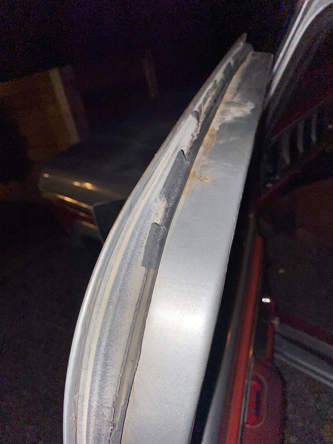

My 78 f150. Judging by the condition they are original. They’re shot but I’ll be painting soon. It’s dark. If you need better pics I can get them tomorrow.

ivsamhain & Ljblue both ... exactly what I'm thinking I'll do after paint.
Thank you both. I don't mind a reduction in road or wind noise.
