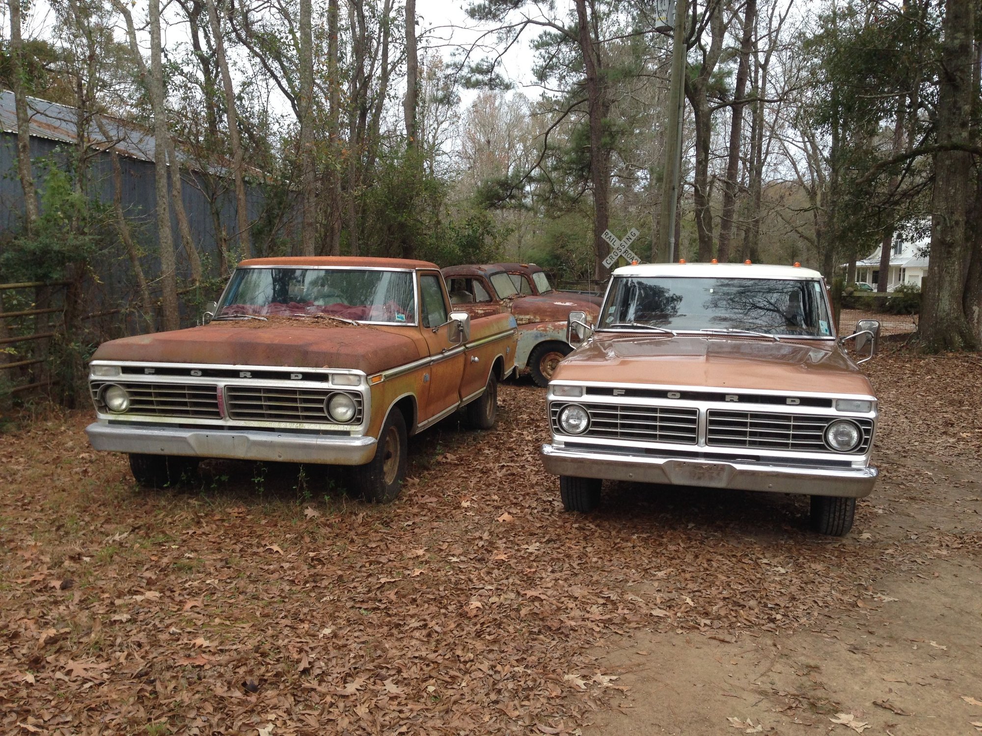

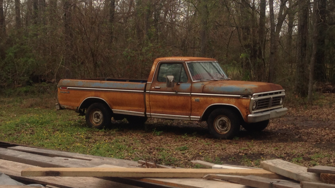

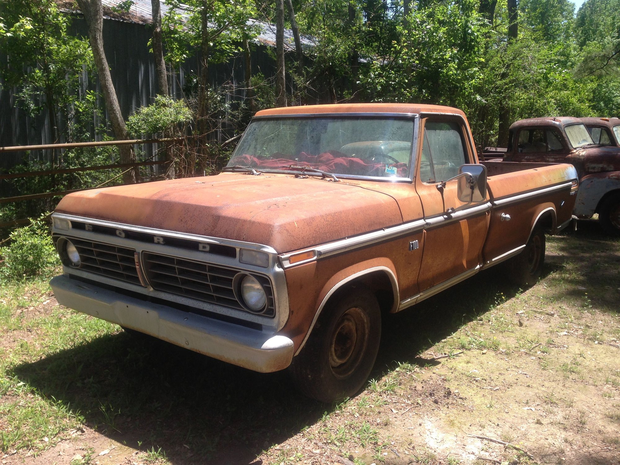

Here is a picture of the Truck, thanks for your help!
