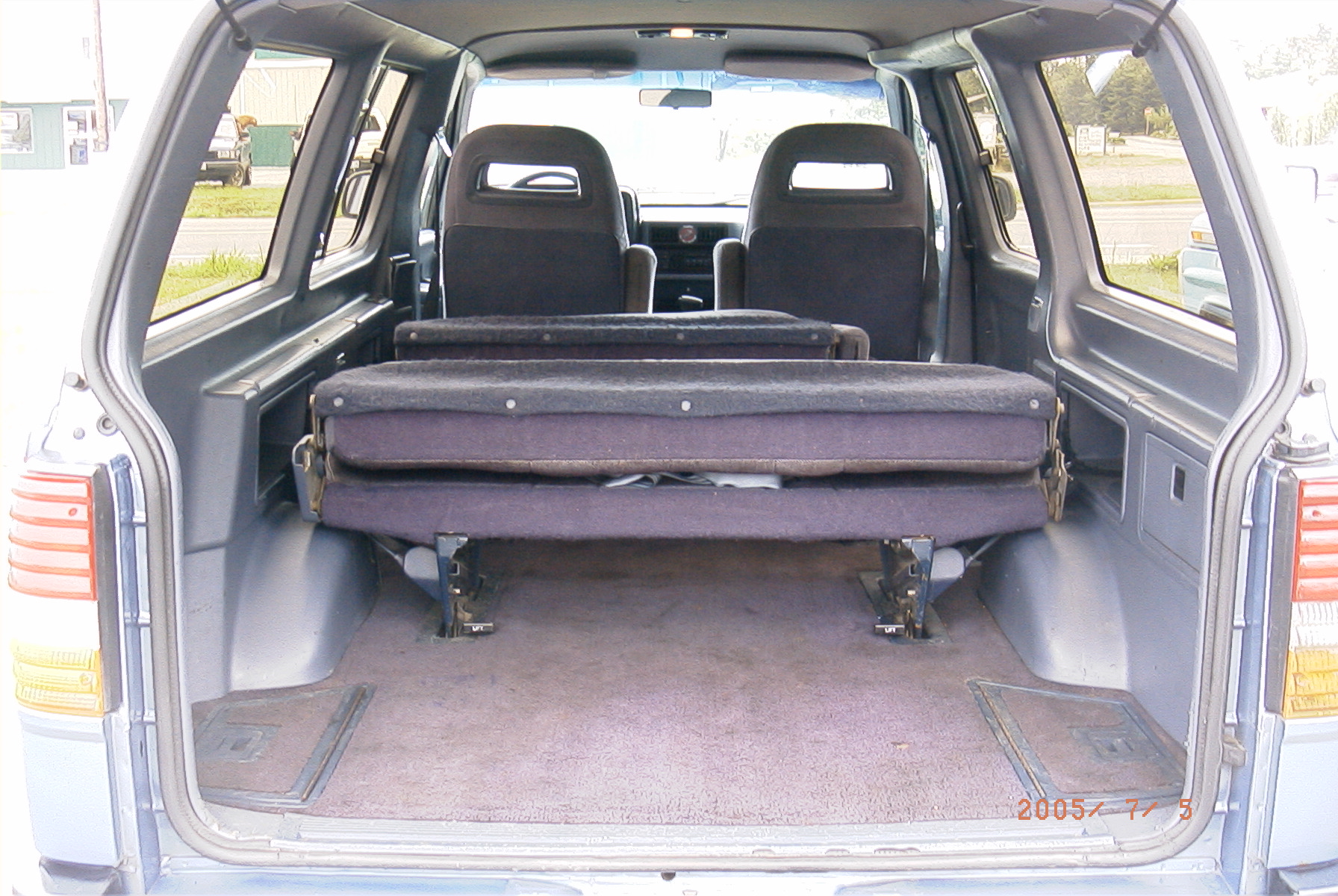

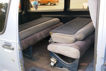

My '89 XLT shorty came with 2nd row captains (integrated belts) with the pass. side a non-tilt, which always made me scratch my head: how to access the 3rd row easily. Turns out that the tilt mechanism for the pass 2nd row captain's is an option in '89! I found the part number for the kit to convert the non-tilt to the tilt, but never got around to picking it up. The Captain's chairs have been in storage for six years . . .
Same van, the 3rd row bench is non-folding -- either direction.
Picked up another shorty '89, it had 2nd & 3rd row benches that fold flat -- either forward or backward. Kept the benches, scrapped the rest.
My '90 also has benches for both 2nd & 3rd rows, both fold either forward or backward flat, like this:
