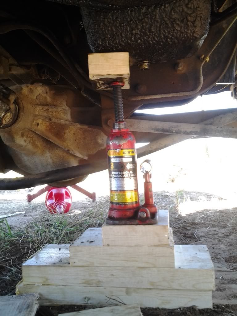

Oh yeah, couple other things I forgot to mention. First, you have to unbolt the motor mount and jack up the motor a few inches to clear the headers during installation. Second, the paint WILL burn off of the headers the first time you start it with them on, so don't freak out when a weird smelling smoke is coming from underneath your truck.
Oh also put a wood block on top of the jack before you raise the motor or you will punch a hole in the oil pan. Here's what I did
