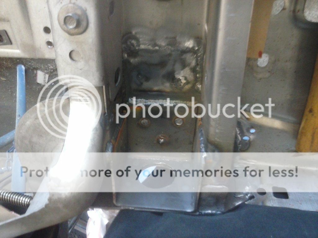

well,i cut the rust out lol
first piece of the vertical channel fabbed,fitted,welded in
the fave piece on.
lower outer built and on

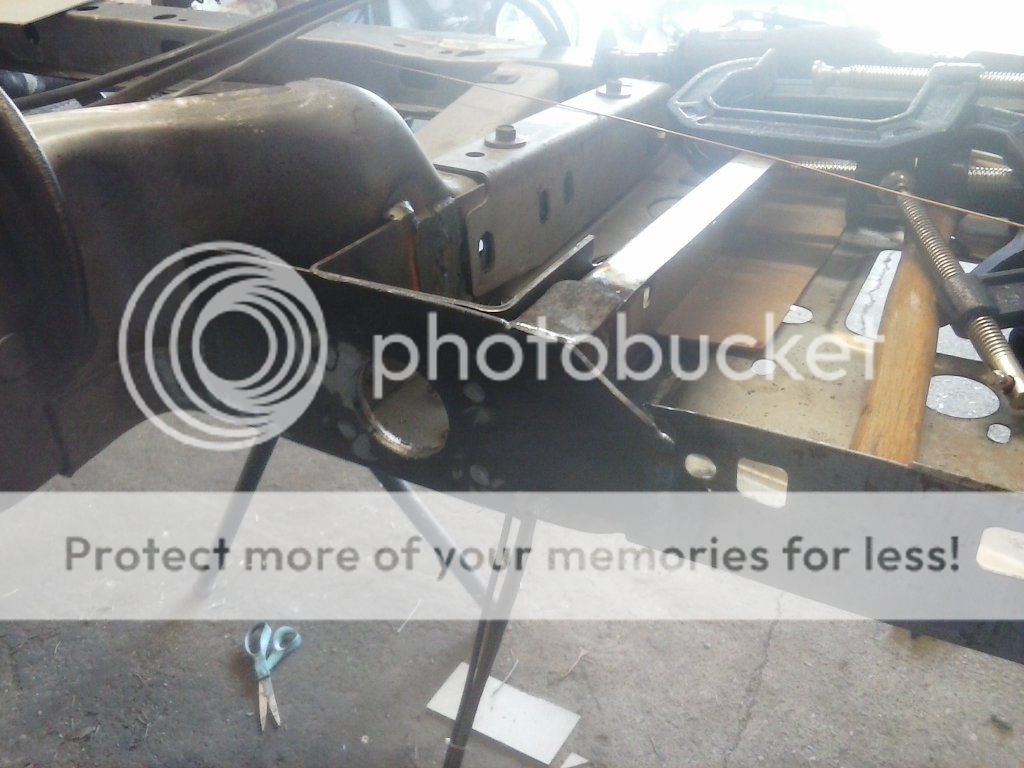

lets see how this 11 gauge makes a box with just a vice and a hammer lol
inner body mount structure bent,drilled for plug welds and clamped in...this is fun..
just about done with the first side.

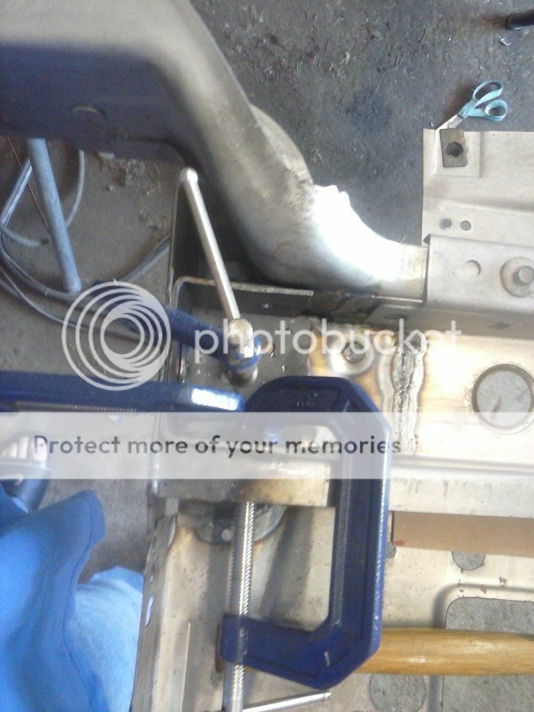

getting close on the second side

inside of the second side
THe front all welded up,the red marker is the location of the cut for 6.0 Ic tube to go through.
6.0 ic mount pass side just tacked on. I welded it after pulling rad support and did some finish work for prep for paint.thats 1" box with 1/8" on either side to provide a tight fit.
