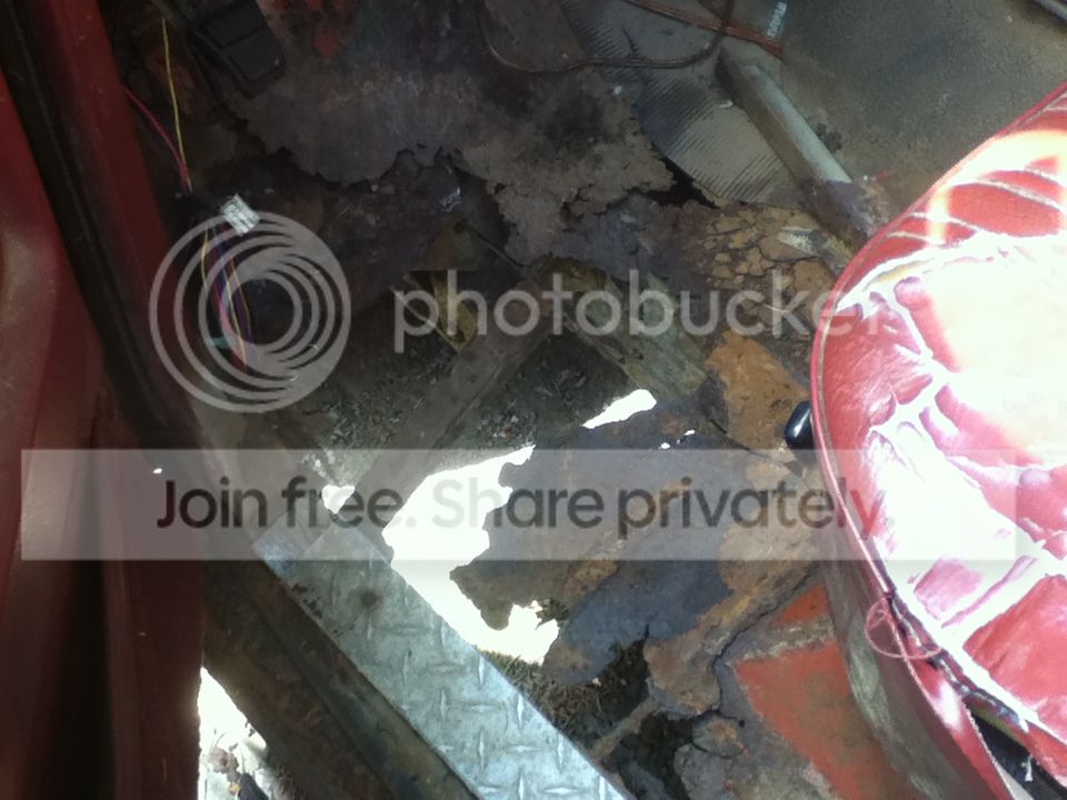

Yeah lol. Bent the snot out of the driveshaft so we had to replace the whole thing and weld a plate over the hole in the floor. That wasn't good enough and eventually rotted out to the point it left me with this (as it currently sits):
That runs all the way behind the seat and into the cab corner with the seat belt hanging through the floor. The seat pan in riding on the frame rail. The red up top on the floor was the last plate we welded in after the driveshaft came through. All gone. Don't let it go too long.
