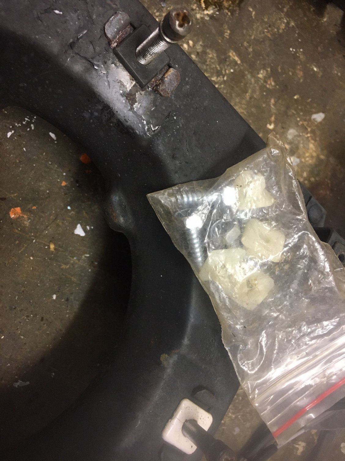

I was rebuilding some headlight buckets for 1973-1977 yesterday. I needed the adjuster nut and looked at every catalog i had. Nobody carries them. I took a plastic licence plate nut that i had and installed it. Works perfectly.

Good tip. I did find the actual part on Rock Auto for much cheaper than the parts store.
Wonderful, you're exactly right, but...What is the part number?
No parts catalog has this nut listed for license plates, but I have a very good memory. Here's the puppy with its original applications:
C2TZ-13181-A .. Nylon Headlamp Adjustment Nut / Obsolete
1961/66 F100/750 // 1961/67 Econoline // 1963/69 N/NT500/1100.
Dealers bought these by the gross from Auveco, where they had both the headlight and license plate applications and the Ford part number.
OBSOLETE RELIABLE PARTS in Nashville GA has 10 = 229-686-5101.
