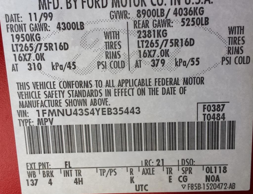

Old Mar 4, 2014 | 01:10 PM
TheCurtster's Avatar
TheCurtster
Joined: Jan 2014
Posts: 123
From: Thousand Oaks, CA
Axle tag decode?
I can't seem to find this code on the earlier posted secret decoder page:
<a href="http://s75.photobucket.com/user/TheCurtster62/media/image_zpsaac01dd3.jpg.html" target="_blank"><img src="http://i75.photobucket.com/albums/i320/TheCurtster62/image_zpsaac01dd3.jpg" border="0" alt=" photo image_zpsaac01dd3.jpg"/></a>
What am I missing?
Thanks!
Old Mar 4, 2014 | 01:33 PM
Bigpipes 35's Avatar
Bigpipes 35
Joined: Feb 2011
Posts: 3,450
Likes: 13
From: Forest lake minnesota
What am I missing?
Thanks!
The codes that Christina posted are the axle codes found on the driver door pillar, By looking at the tag you have it looks like you have a 3:73 limited slip axle with a 10.5 ring gear..
Old Mar 4, 2014 | 02:02 PM
TheCurtster
Joined: Jan 2014
Posts: 123
Thanks, Chris. Finally found it on the door tag too. Kinda figured that's what I had, but wanted to be sure for some reason.
Curt

Gear ratio change
Originally Posted by rch10007
Trying to figure out what I have here...
Attachment 200001
I need to know if we change our 4.10 ratio to 355, will the tranny work well or ???

You have posted in a three-year-old thread in the "Excursion - King of SUVs" forum. While Excursions do some towing etc. , you might have better luck starting a new thread in "1999 to 2016 Super Duty" to get some answers flowing.
That having been said, I looked up your VIN. It looks like you have a 7.3 diesel. It will do fine with either gear ratio. If you change the gear ratio for nearly $zero , you might see a slight fuel economy benefit over time. If you are paying to get the gear ratio changed, you'll likely never recoup that amount of money in fuel economy alone . . . unless you have a cab-high camper shell and the trailer tucks in nicely behind it and doesn't catch any additional air, and you are going to drive this combination a hundred thousand miles.
The difference between the two gear ratios is only 15%. Slowing the engine down 15% will make little difference in fuel economy, and speeding up 15% (to get there faster at the same RPM) will use more fuel.
Doing some math for fun: Let's say you get 10MPG right now, fuel costs $3.00/gallon, making this change costs $1,000.00 and it gains you 2MPG. It would take 20,000 miles for the 3.55:1 gear ratio to pay for itself. The whole time, you'll be shifting down about 15% more often. Depending on what you are towing, I think 2MPG from this change would be amazing.
Doing more math for fun: Let's say you get 12MPG right now, fuel costs $3.00/gallon, making this change costs $1,000.00 and it gains you 2MPG. It would take 28,000 miles for the 3.55:1 gear ratio to pay for itself. The whole time, you'll be shifting down about 15% more often. Depending on what you are towing, I think 2MPG from this change would be amazing.
Since I'm here, I threw this together really quick based on a $1,000.00 gear swap:
Based on $1,000 for a gear swap and $3.00/gallon fuel price). The green is where I imagine you are with a normal travel trailer and potential mileage improvements, and the boxed numbers are the numbers from above. If you were talking about an empty truck, I'd say you'll see some real improvement, but with a trailer (unless small) I don't think you'll see that much if any. If you happen to be able to swap gears for much-reduced price, then that changes things . . . still with little or no economy improvement.
Disclaimer: My opinion, based on my experiences. Results may vary. Professional driver on a closed course. Yada yada.
